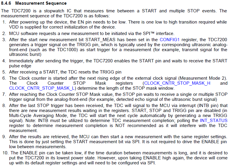

I am using TI's
http://www.ti.com/product/TDC7200
with STM32F407. The interface is SPI. I am able to read and write into thehttp://www.ti.com/product/TDC7200
registers (CONFIG1 and CONFIG2) over SPI without any problem. As per the TDC7200 Datasheet, upon writing a 0x01 into the CONFIG1 register of the TDC7200, a TRIGGER signal will be set by the TDC7200, which will be reset only after a START signal is received by the TDC7200.The issue is that after I write a 0x01 or 0x03 into CONFIG1 register, I don't get any TRIGGER signal. I am able to read back the same CONFIG1 register and see that the register value has changed to whatever I have configured. The values of other registers are kept default and only CONFIG1 register is modified. I have checked the CLOCK - its 8MHz, SPI CLOCK - SCLK is 8MHz, and there is a LOW to HIGH on ENABLE Pin at the beginning as well (as per the datasheet). I have monitored the TRIGGER pin of the TDC using Oscilloscope, it doesn't go HIGH.
For my purpose, I am not using
http://www.ti.com/product/TDC1000
. Both TRIGGER and INTB ofhttp://www.ti.com/product/TDC7200
are connected to MCU (STM32F4) as interrupts. The purpose is to send START (followed by STOP) signals to thehttp://www.ti.com/product/TDC7200
upon receiving TRIGGER interrupt, and then get INTB interrupt from TDC7200 after STOP Signal and then proceed for calculations of TOF.What could be the problem ? Why am I not able to get TRIGGER interrupt from
? Is there something that I have missed ? Can someone help ?The Measurement Sequence, as described in the TDC7200 datasheet is as below:
For reference I have attached the Datasheet of TDC7200 as well.
Thanks in advance.
-Ananth

‎2017-06-22 10:41 AM
Did you measure directly on TDC7200's pin2?
Also check for shorts to ground and neighbouring pins/tracks.
Isn't the connected pin on STM32 set to output?
‎2017-06-22 11:34 PM
Hi Jan,
Thanks for the reply.
Yes, I measured the TDC7200's Pin-2 directly. I have monitored the
connected STM32F4's Pin (PE14) as well. Both show the same.
No. I have configured that pin as an external interrupt - Pin PE14 as
GPIO_EXTI14.
GPIO mode :* External Interrupt Mode with Rising edge trigger detection*
GPIO Pull-up/Pull-down : No pull-up and no pull-down
Is this the issue ?

‎2017-06-23 5:51 AM
Sounds to be OK, I don't have any further ideas where to look... maybe you should try to as at TI.
