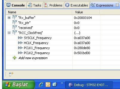

mehmet.karakaya
February 23, 2013
Posted on February 23, 2013 at 18:02
RCC_APB1PeriphClockCmd(RCC_APB2Periph_USART1, ENABLE);
this line was wrong indeed I corrected it and USART1 interrupt started to work however this time the received characters are garbage ( I observe with JTAG) ( not equal to the ones I send from PC ) have I fried the usart1 pins ? becouse this code was absolutely working at STM32F103

mehmet.karakaya
February 24, 2013
Posted on February 24, 2013 at 13:38
hello Clive , as you have said I looked closely at the crystal it is neither 25 nor 8 MHz - it is 12 MHz but the HSE_VALUE is declared as 25 MHz
#if !defined (HSE_VALUE)
#define HSE_VALUE ((uint32_t)25000000) /*!< Value of the External oscillator in Hz */
#endif /* HSE_VALUE */
however the RCC_ClockFreq gives the correct values as you can see at the attached picture above --> 168 MHZ , 42 MHz and 84 MHz if I declare the HSE_VALUE as 12 MHz the clock values changes ( not 168 Mhz anymore ) more strange ; I measured the baud rate as ~ 4500 Kbaud with osciloscope with my original baudrate setting of 9600 I changed it to 19200 and I could comunicate with my board succesfully at 9600 baud (PC) my board is produced by OLIMEX and I think they adjusted the below function according to 12 MHz crystal I want ask which line I have to change and how , to get correct values of baudrate and system clocks thank you

Tesla DeLorean
Guru
February 24, 2013
Posted on February 24, 2013 at 15:02
The RCC_ClockFreq structure is a pure computation exercise, not a physical measurement.
You need to set the compilers command line to have the define -DHSE_VALUE=12000000 this may be a compiler related project setting, or done more explicitly.
The you will need to go into system_stm32f4xx.c and modify one or more of the PLL_x values. For integer HSE values, probably just PLL_M
#define PLL_M 12 // Divide HSE to get 1 MHz comparison frequency
