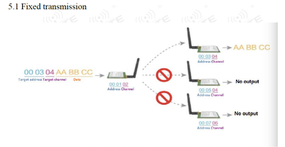

in the documents of datasheet it says : "in fixed mode..."
data[0] is 0x00 which is ADDR High
data[1] is 0x01 which is ADDR Low
data[2] is 0x32 which is Channel (410.125MHz + data[2]*1MHz = 460.125MHz)
so I am sending uint8_t data[5] = {0x00, 0x01, 0x32, 0x03, 0x03}; through to the E220 in tranciever board.

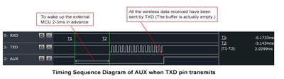

From personal experience with these modules, I'd say you should also measure the AUX timing precisely. Do this with an oscilloscope and adjust the following constants:
#define E220_MODE_TIMEOUT_MS 40U // Timeout for E220 Mode switching
#define E220_TX_TIMEOUT_MS 2U // Timeout for E220 packet send

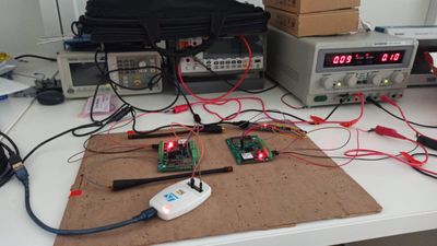

Here is my test station. I got 2 boards with STM32F446VET7 and LoRa E220-400T30S & 2 410-480MHz antenna.

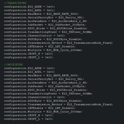

Here is my Transciever and receiever configuration for fixed mode:
and first three byte of data is ADDH(0x00) - ADDL(0x03) - CHANNEL(0x04) of receiever.
uint8_t E220_tx_Buffer[8] = {0x00, 0x03, 0x04, 0x0B, 0x0C, 0x0D, 0x0E, 0x0F};

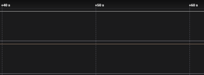

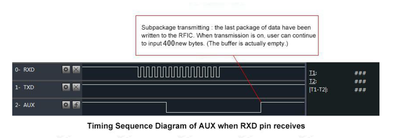

This is the transciever logic analyzer image:
RED is module RX pin which microcontroller TX.
Orange is AUX pin and it always LOW.
This is the receiver logic analyzer image:
White is module TX pin which microcontroller RX always high.
Brown is AUX pin and it always LOW
2024-08-06 8:37 AM
According to the waveform you shared AUX pin is always Low, and according to sections 5.5 Reset and 5.6 AUX description from E220-400T30S_UserManual_EN_v1.1.pdf, your modules are not in a transmit or receive state.
After reseting module, no UART transfert, could you observe AUX pins go High?
Do you confirm that M0 and M1 are Low to put each module in normal mode (see table 6 operating mode) ?
Do you confirm both modules are properly powered?
Could you share the schematic of boards?
Best regards,
Romain

I recheck my connection. Unfortunately I connect ANT to logic analyzer instead of AUX.
I fix that.

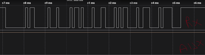

Now my true signals
I do the GPIO SET on M1 and M0 for configuration (deep sleep - configuration mode)
I do the GPIO RESET on M1 and M0 for transmission & receive (normal mode)
ON THE TRANSMITTER SIDE
TRANSMITTER CONFIGURATION SIGNAL :
(WHITE ONE IS TRANSMITTER RX WHICH MCU TX, OTHER ONE IS AUX)
DATASHEET :
TRANSMITTER TRANSMISSION SIGNAL :
(AUX ALWAYS HIGH)
ON THE RECIEVER SIDE
RECIEVER CONFIGURATION SIGNAL :
(WHITE ONE IS RECIEVER TX WHICH MCU RX, OTHER ONE IS AUX)
Datasheet :
RECIEVER RECIVE SIGNAL :
(AUX and RX always high)
