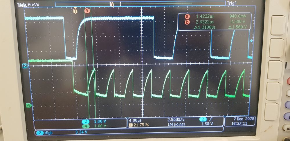

Then I measured and I get that 0693W000006EojXQAS.jpg SDA and SCL rise time = 1.2us.
Attached oscilloscope picture.
I tried to change configuration to  “GPIO_InitStruct.Speed    = GPIO_SPEED_HIGH�? but I didn’t see any change.
Please advise.

waclawek.jan

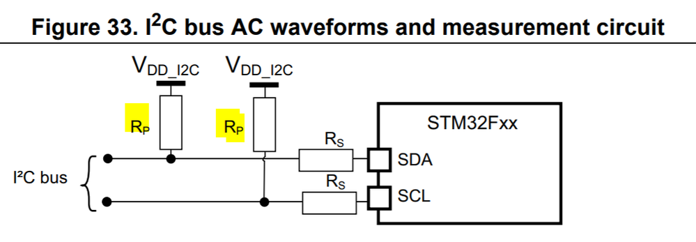

I2C signals are driven by Open-Drain transistors, and their rise time is given by pullup resistors you are supposed to add externally.
The internal pullup is nominally cca 40kOhm, which may be sufficient only if the load is of low capacitance.
The datasheet measurements are taken with a 4.7kOhm pullup resistor. Guessing you don't have any.
gil23
Thanks, it's woks,
I connect 4.7K pullup and the rise time is 100ns

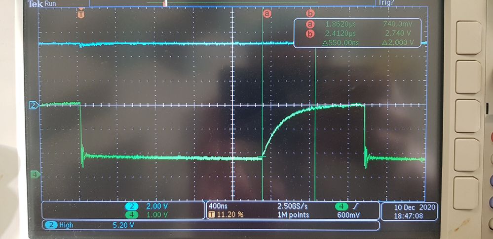

gil23
Problem didn't solve completely,
I connect another STM32F401RET6 board, and I configured it with the same project only as a slave.
I connect 4.7K pullup between master board to slave board.
the rise time is now 550ns.
Please advise.
(ignore)
waclawek.jan
The risetime is simply given by RC constant. 550ns/4k7=cca 110pF, not an entirely unreasonable value, especially if you connect two boards with lengthy cables.
You can decrease the pullup's value, taking into consideration the maximum allowable pin current.
