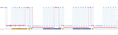

 I've noticed some spikes when the STM32 I2C controller generates the answer, see below (yellow markings)
Blue: Clock generated by the controller (the clock speed is about 200kHz)
Red: Adrdess Byte generated by the controller, Data Bytes generate by STM32 I2C transmitter (answer) with spikes
When the FREQ Bits of I2C_CR2 Register are zero, this spikes doesn't occur, see below

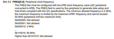

The Reference Manual RM0368 Rev 6 for the I2C CR2 writes:
It is noticed that this FREQ bits must be configured to generate I2C compliant Signals. Anyhow from EMC perspective this spikes are bad because the radiate a wide spectrum. I've found nowhere information of correct I2C specifiation/behaviour of the Data Signal the be compliant, anyhow the data is transfered correctly to the controller.
