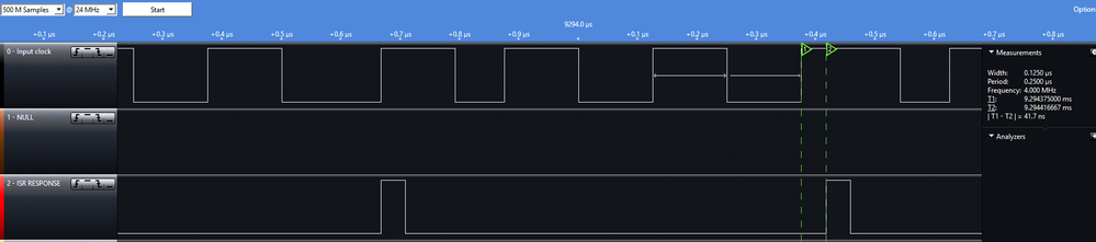

I wrote a code to generate rising edge interrupts for a 4MHz clock input to the board. The 4MHz input is generated by MCO while the core is pushed to 168MHz.
I found that certain interrupts are not being tacked at all and when they are tackled, there are delays often (but not always) for the Microcontroller to enter ISR.
I am simply toggling external pin in the ISR

Following is the image on Logic analyzer we captured.
Can someone enlighten me regarding what the issue can be?

I wonder how many cycles it takes for stm32f4 to go into an interrupt and toggle a pin. Perhaps more than 168/4 cycles? Anyone?

Interrupt latency is typically about 12 clock cycles for a Cortex-M4 CPU (best case), assuming that the memories involved can operate with 0 wait states.
The pulse you are attempting to generate in the ISR should be about 6 ns wide.  Is your analyzer able to capture signals that short?  Incidentally, it's doubtful that the GPIO pins can even operate at that speed.
