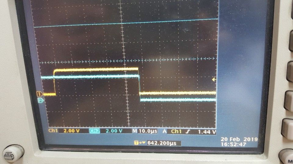

I have a strange behavior with STM32F4-DISCOVERY I2C communication.
My system includes an STM32F4-DISCOVERY, a BLDC motor, a flow sensor (SDP601), and a pressure sensor (MS5525DSO). The motor works as a blower and 2 sensors measure the flow and pressure from the tube. 2 sensors share a same I2C line (PORTB PinsPack 3) since they have different slave addresses.

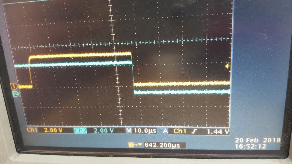

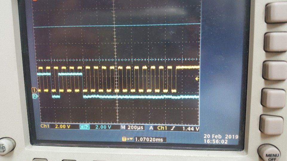

I have no problem with reading the flow sensor. Also there's no problem when reading the pressure sensor when the BLDC motor runs at a low speed. The problem comes when the motor runs at higher speeds: after a while, SDA line is pulled low and there's no way to recover it (I have manually set the GPIO pin high, sent I2C_START/STOP command, or reset the I2C module).
When I zoomed in, it seems that the SDL (blue) is pulled low before the SCL falling edge. This bug always happens after MCU sends the slave address (0x77) when I try to send 0x00 to the pressure sensor. I don't know if it that makes a START condition in the line so the communication was hung or not.
When reading well, that signal is like this:
It is strange that it only happens when I send some specific commands such as 0x00 ("Start reading" command). But when I send 0x40 or 0x42 or 0x44 ("Start conversion" command), there was no problem.
Could anyone suggest any problem? I have checked the supply voltage during the failure but there was no problem. I also can't find any glitching signal. I'm running the I2C module at 10K Hz, sensors supply voltage 3V (from STM32F4-DISC board). The power source for BLDC motor is from a 24V adapter which is separated from the MCU power source (from PC). However, they share the same GND.

‎2019-02-20 11:02 PM
For debug purpose:
- Make sure all the I2C traffic is coming from the same code place. No I2C message within interrupts.
- Use my GPIO I2C code shared in this forum to test. It includes error recovery management.

Thank you for your prompt reply. The bug happens at a same place. Whenever I send 0x00 command to the pressure sensor, the communication hangs right after the slave address (0x77 or 0b1110111) is sent. As you can see from the picture 1 and 2, the problem occurs the last bit "1" in the SDA line.
I also tried debugging in the main loop and it happened at the same place.
