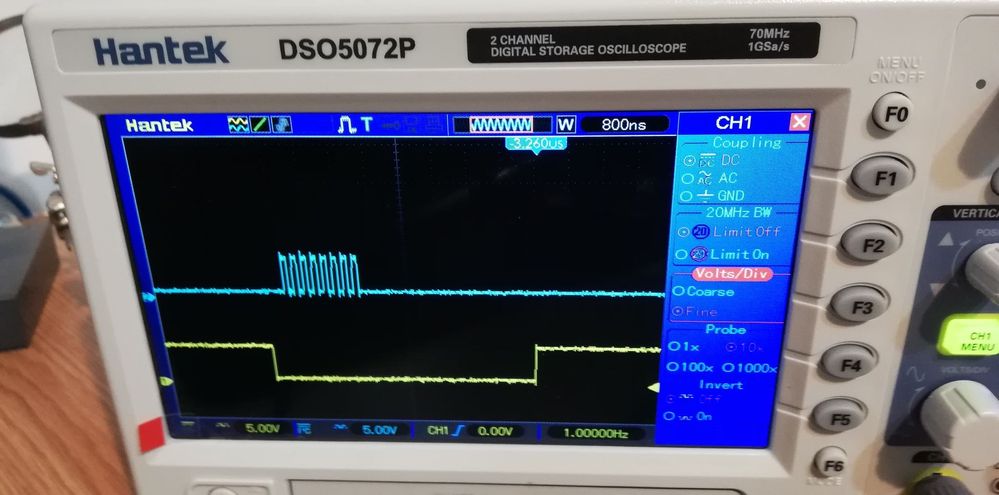

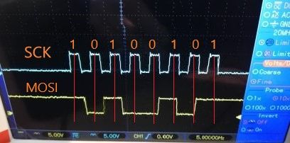

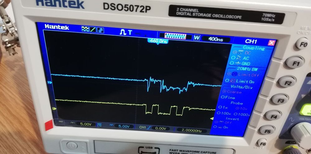

Below are the oscilloscope snapshots:
This is MOSI(yellow) data comming from arduino(master).
MISO(blue). I'm not sending anything from the code on my ST board I guess the value there is because of the way SPI works in hardware(circular buffer).
0693W000005Bvs3QAC.jpgThis is SCLOCK coming from the master(arduino) and SS.
