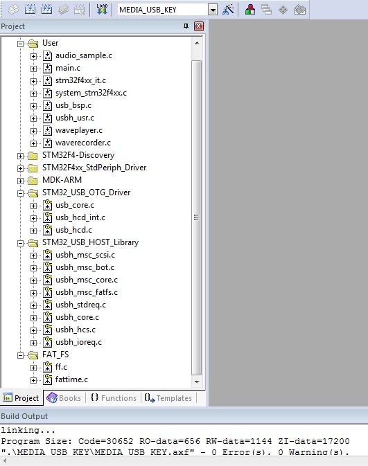

I tried to build a project using the provided source code in Eclipse IDE.
Added all the files related to USB. Now I am stuck with an error ''
../src/diskio.c:26:29: error: 'USB_OTG_Core_dev' undeclared (first use in this function)
''. I searched in all the files, but couldnt find a define '
USB_OTG_Core_dev
'. Please let me know what value shall i define for 'USB_OTG_Core_dev'.
Posted on August 23, 2014 at 12:21
Perhaps you're not supposed to be using that file? Have you looked at the construction of any other of the projects for the supported tool chains? They are in ASCII, and human readable..
Perhaps you should be using STM32F4-Discovery_FW_V1.1.0\Libraries\STM32_USB_HOST_Library\Class\MSC\src\usbh_msc_fatfs.c ? and not diskio.c (a generic form)

Posted on August 24, 2014 at 15:04
Odd then, that the project in Keil, using the correct files, compiles just fine....
Perhaps you should read my previous advice more slowly, instead of dumping all the files you can find into the project?

Posted on August 25, 2014 at 15:29
Please let me know the list of header files also.
This seems to involve a lot of work on my part to do your job. Attached is a dependency tree, in ASCII, parse it with AWK or PERL

Posted on August 26, 2014 at 15:53
Stop using DISKIO.C isn't not part of the project, I told you this last week. The functions declared in diskio.H are implemented in another file.
