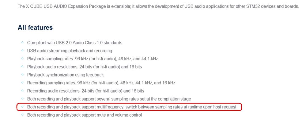

X-CUBE-USB-AUDIO multifrequency.
Pawel Piwowarski
Hi.
In X-CUBE-USB-AUDIO, You wrote:
1. Does it mean that playback and recording can work simultaneously, and at different sampling rates? For example, playback at 44,1k, and recording at 96k?
2. Does it mean that playback and recording may by governed by different software (at PC) as separate devices? For example, playing using Foobar2000, and recording using Audacity?
3. If 1 and 2 is "yes", does it mean that can we have asynchronous streams?
For example, playing at 44.1k, and recording at 44,1k but from different clock domains? For example, playing 44,1k clocked from STM32H7xx, and recording from incoming SPDIF (SPDIF is always clock master, so it forced its own clock, which always is slightly different from STM clock)
Questions 3 is general, about UAC2 devices. If it is not yet implemented in X-CUBE-USB-AUDIO, but general possible, please answer anyway. Implementing by myself is not a problem, but I need information if it is possible at all (in UAC2).
Thanks in advance!

Could I please someone to answer, preferably someone from X-CUBE-USB-AUDIO library creators?
What exactly "multifrequency support" mean in X-CUBE-USB-AUDIO description?
Maybe I'm not a native english speaker, but I'm near sure that "multi" means "many at the same time", not "one chosen from many".
So I'd like to make sure that X-CUBE-USB-AUDIO actually supports many (at least two) frequencies at a time. Not only allows to choose one from a variety of available options (on the fly).
