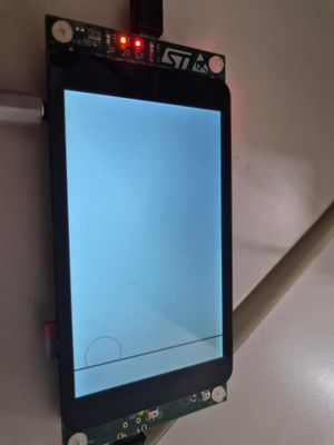

However, when I comment out the LTDC clock configuration:
// PeriphClkInitStruct.PeriphClockSelection = RCC_PERIPHCLK_LTDC;
The audio playback works again, but the display shows an artifact—a black line appears on the screen (as shown in the attached image).
Have you looked at the display interface lines with a logic analyser or scope to see what's happening?

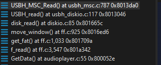

I forgot to put my code in there im sorry for that. its happening on line 19 here or when you have downloaded the file on line you will find it in audioplayer.c on line 42 on the f_lseek function it gives me the fatfs error "FR_DISK_ERR".

And here you can see what happens.
So step into that function to see exactly what fails, and where.
Again, have you looked at the interface lines with a logic analyser or scope to see what's happening?
So Ive stepped into the function and saw that the main problem is happening in usbh_msc.c at line 785.
MSC
  if ((phost->device.is_connected == 0U) ||
      (phost->gState != HOST_CLASS) ||
      (MSC_Handle->unit[lun].state != MSC_IDLE))
    return  USBH_FAIL;
 MSC_Handle->unit[lun].state is for whatever reasons on MSC_READ...
i dont know how to fix it by now.
