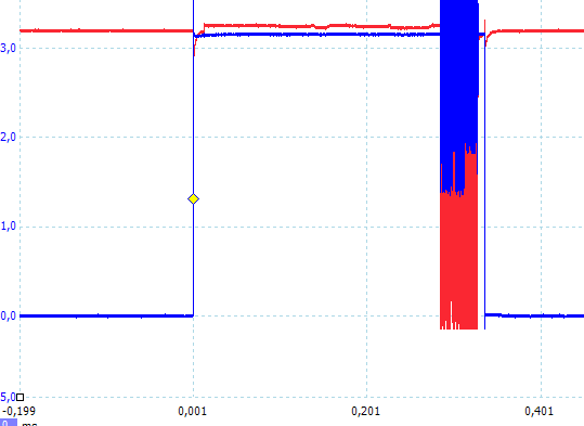

I've found the cause of the bad throughput (but not the reason).
I tried to read 2 blocks with the multiblock function and I was surprised to see that the time was not 1ms, but about 520µs..
So I had a look at signals :
- in blue, a signal which rises just before calling the ReadBlock function, and falls after the ReadBlock function.
- in red, the SDIO_D0 signal
It clearly appears that there's an extra 350µs before any read sequence.
Anyone knows what is causing this, and how to reduce (or cancel) this delay ?It does not seem to be related to the DMA setup phase. I could measure that 99% of the 500µsec time was spent in :
while ((DMAEndOfTransfer == 0x00) && (TransferEnd == 0) && (TransferError == SD_OK) && (timeout > 0))
{ timeout--; }Thanks.
Best regards,Vincent.

2017-08-23 12:19 PM
Haven't dug into SD architecture in years, but I'd assume there is a 'seek time' related to pulling the 128KB block from the array, ie fetching from the slower NAND array into a 128KB RAM holding buffer that then gets streamed out.
Doing a read across multiple blocks will likely initiate a prefetch on subsequent blocks, so within the time frame of transferring block N across the interface block N+1 will be ready. So subsequent blocks have zero or minimal fetch times.
2017-08-23 1:32 PM
Thanks Clive.
I understand there can be some 'seek time', but doing this :
1. ReadSingleBlock N
2. Wait 1ms
3. ReadSingleBlock N+1
Step 1 gives 500µs, step 3 gives also 500µs .. wherease ReadMultiBlock (N and N+1) gives approx 550µs ..
I'm not sure if this delay is only due to the SD card.
2017-08-23 1:51 PM
You're talking to a micro controller on the SD card which has the brains on an 8051, that manages the protocol, and initializes the transfers. The fetching and transfer is likely all handled by hw state-machines.
