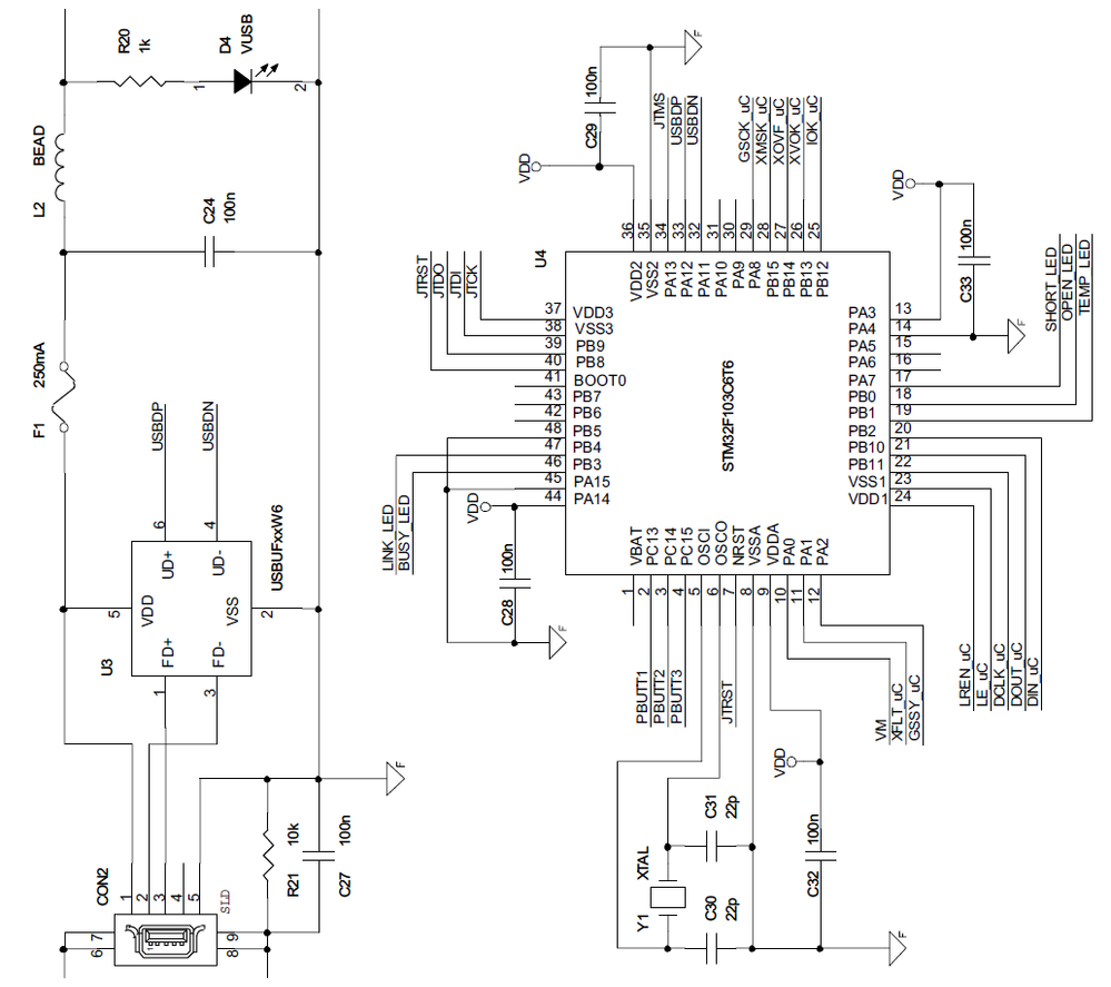

We are looking to buy the evaluation board STEVAL-ILL035V1 but noticed some strange things about the circuit around the MCU (STM32F103C6T6).

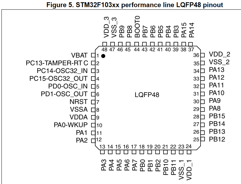

Comparing it to the actual data sheet of the MCU, the pins do not match. Furthermore, there are a lot of strange things about the pin connections. For example, pin 37 VDD3 and pin 38 VSS3 are connected with JTCK and JTDI, respectively and BOOT0 pin is not connected to anything.
This makes us believe that there is something wrong with the datasheet provided and would like some clarification, and a corrected datasheet if possible.
