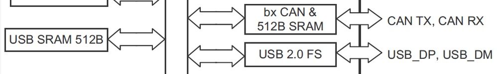

I read on this forum that due to shared memory space you cant use CAN and USB at the same time on the F103 performance line devices. Does this also apply to the F303 as fitted on the F3 Discovery board?
Is there some workaround?

Posted on March 16, 2016 at 02:22
The F1 is a VERY old design.
The F3 has separate RAM for the USB and CAN FIFO's, per the Data Manual
