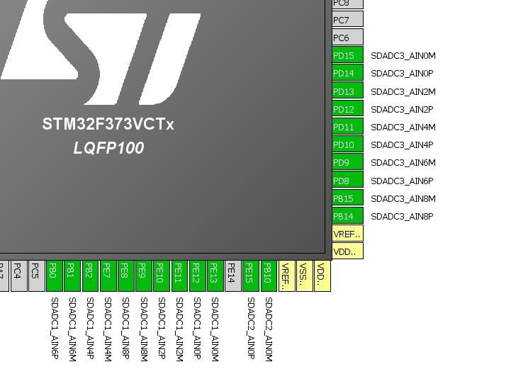

    How many differential channels can be used in one STM32F373MCU(LQFP100)?
    ST technical training documents says maximum differential inputs is 10 for all packages. But, in CubeMX?I can configure 11 channels in differential mode,that is 5 channels for SDADC1 and SDADC3,and 1 channels for SDADC2,which comes up to 11 differential channels in total.Confused about this.
    See picture below
