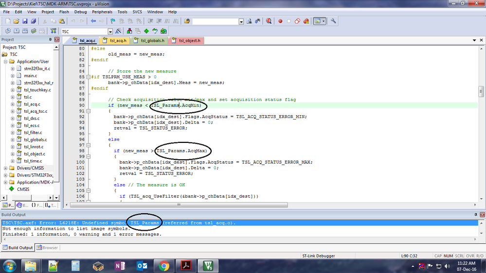

‌ I have copied the library files from the firmware package for STM32F3 series v1.6 to the code generated from STM32CubeMX on Kiel v5. I've encountered driver problems and have searched the project and the Touch Sensing library thoroughly. The definition found in tsl_globals.h and the usage in tsl_acq.c for TSL_Params are not matching. Using
STM32F334R8-Nucleo board & t
he error is as follows -
TSC\TSC.axf: Error: L6218E: Undefined symbol TSL_Params (referred from tsl_acq.o).

Hello b_u.vishal,
The 'Undefined symbol' error means that your application does not include object, source or libraries including this function.
You should review the configuration of your project, and the files included and make sure that your project contains all the required library source files.
You can take a working example within STM32CubeF3 firmware package, check configuration and implementation,  compare the code/functions with yours and make updates according to your needs:
STM32Cube_FW_F3_V1.6.0\Projects\STM32373C_EVAL\Applications
Hope this bring you some help.
