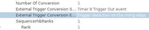

I need to have 2 adcs triggered simultaneously. Since i desire 3 differential inputs per ADC for the Nucleo F303zre board i can use ADC 1 and ADC3 .
STM32CuneIDE shows the Timer 20 trigger out event is available for both ADC triggering so i intend to use that for say a 1Msamples per second sampling rate.
  • Will using the same timer (e.g. timer 20) ensure both ADCs start at the same time?
  • Any examples for simultaneously triggering 2 ADC1 and ADC3 channels simultaneously?
Thanks
David
2 REPLIES 2
AScha.3
just set it as you like in Cube ,
for example : i use ADC1 + 2 and TIM8 , on F303 .
set adc trigger:
Hi AScha ,
So as i understand from you i will achieve the simultaneous sampling .
