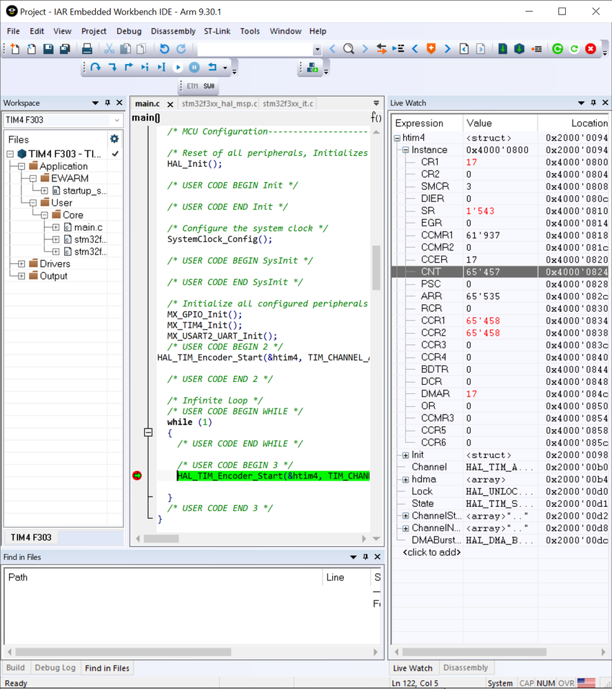

I'm having an issue where, after configuring timer 4 in encoder mode using the HAL, the CNT register is not updating while the encoder is turned. Messed around with it for some days but still can't get it to work.

I'm running timer 4 off of the PLL*2 output. I can verify that the PLL clock is working as its powering my USB functionality. The timer 4 clock is therefore running at 96MHz. Possibly too fast, but that is about the only thing I can imagine is going wrong. I've changed plenty of things about the configuration, such as input filtering, polarity, GPIO speed, all just to see if I can get it to actually work. No changes to CNT, verified through live expression debugging and UART printing the value. The square waves from the rotary encoder don't have any bounce (as expected from an optical encoder) but have a rise time of about 312ns. Any help will be appreciated

Timer 4 didn't work in encoder mode. It works now using Timer 3. I don't know why, but that's the change I had to make.

I don't see any fundamental reason why wouldn't TIM4 run from
The debugging steps might've been:
  • verifying connectinon to pins by observing bits 12 and 13 in GPIO_IDR while slowly moving the encoder
  • checking all related jumpers/solder bridges on the board
  • reading out and checking/posting content of TIM and related GPIO pins' content
  • trying to avoid clocking of TIM4 from PLL, if it sounds to be a concern

Hello @ASnow.1​ ,
It should work for TIM4 in polling and interrupt mode as well. Attached an example TIM4 in encoder mode.
