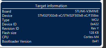

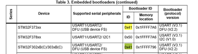

@TDK - Thank you for the information. I have been looking through 2606 document and became a bit confused. The only reference to the STM32F3xxx in Table 3 states that bootloader ID is 0x50 @ 0x1FFF F796:
Yet, reading the flash at that address, reveals 0x41 as the ID:
which from the table relates to different STM32 devices than the device that is connected:
I am supposing that the flash doesn't lie, but it seems inconsistent to the documentation.
EDIT: Update: the 0x41 is correct after opening my eyes a bit:

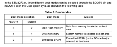

It seems I am most interested in the nBOOT1 option byte, as I have electrical control of BOOT0.

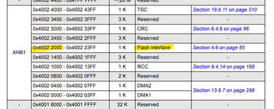

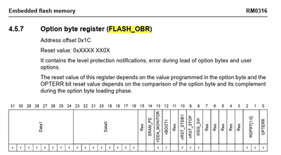

From RM0316 for STM32F303 it states that the Option Byte register (FLASH_OBR) is located at offset 0x1C. Offset from where I cannot seem to figure out:

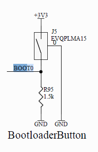

@AScha.3 - Thanks, I was incorrect RE the BOOT0 resistor:
I have verified logic low on the Boot0 input. I am not sure soldering to GND will make any difference here.

Use STM32CubeProgrammer to view the option bytes. When connected, select the OB tab on the left.
The offset is from 0x40022000 as seen here:

Hi @TDK - I tried reading those addresses, and when I did, the programmer yelled at me, and said the "read failed".
But, it looks like I may have a BOOT0 problem as I think the BOOT0 (J5) switch is rotated mechanically on the board and seems BOOT0 is high on this particular board. I am removing it now to verify 0V on BOOT0. Kudos to @AScha.3 for the insight to look into this.
‎2024-03-08 9:29 PM
It turned out to be a HW issue that @AScha.3 made me investigate further. The switch on the board for BOOT0 high/low was mounted incorrectly and caused BOOT0 to be logic 1 for this particular board.
There was no other electrical way to get BOOT0 to logic 0 other than removing the BOOT0 selection switch from the PCB:
