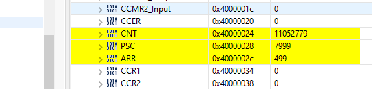

Migrating from STM32F103 to STM32F303, I mostly copy&paste my code from STM32103 to STM32F303, and only adjust what's necessary. However, I am having troubles with the TIM2 peripheral. Before starting the counter, the CNT register shows the correct reset value of 0x0000. My ARR register is set to 499. When I start the timer, I do not enter my ISR. When I halt the program, I see that the counter has incremented far beyond my ARR value (11052779 when I halted the program). The ISR was not entered between CNT=0 and CNT=11052779).
When I let the program run for a while (couple of minutes), the counter keeps incrementing until an overflow occurs (counter value > 2^32), starting from 0 again. When this happens, I enter the ISR, service it and leave the ISR again. Then, my ISR gets entered every 500ms, as supposed.
Can anyone tell me, why the counter misses the first ARR, needs to go all the way up to 2^32, overflows, and then matches the ARR regularly in the required 500ms intervals? Comparing the ref manuals of these two microcontrollers, the only difference I notice is that TIM2 on the F303 is a 32bit counter.

Te ARR is preloaded. So will update in first update event.
Clear ARPE bit in CR1 before you load the ARR or leave it as is and before start counter, make an update event by setting UG bit in EGR (to update the ARR shadow reg)

Thank you very much. That makes sense. It works as expected now. Thank you.
