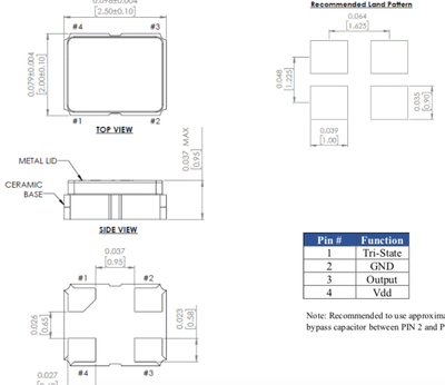

Thanks for all the information! I'll measure the exact bitrate to be sure about it.
The oscillator I'm using is an Abracon SMD.
