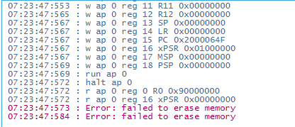

I am trying to develop an external loader for an SPI Nor flash and i am not being able.
All the documentation is referred to QSPI. In the TouchGFX documentation the S25FL032P_STM32G071B-NUCLEO.stldr loader is mentioned for this purpouse. However, i could not find the source of this project to serve as example.
Finally, i have tried to develop my own loader and the testing of the flash is correct, but if i try to use it through CubeProgrammer it fails. The log file changes a lot with small changes in the code...I have tried to only fill the Init() function and left blank the EraseSector and Write functios and even in those cases the log file shows that the EraseSector has failed...

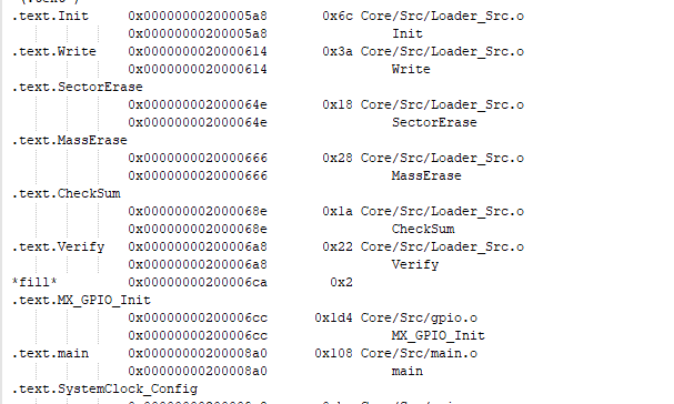

Check the .MAP file to see which function it is calling via PC.
Given that it failed immediately (time stamp), I'd guess you just faulted the CPU, the call didn't look to return, and the tool might have tried to read the memory directly.

I have checked the .MAP file and it seems to fail in the SectorErase function:

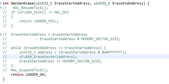

What bothers me is the fact that if i left the function empty, as i show in the next figure, it halts in the same way.
What could i debug with de UART? I have tried to toggle one GPIO output in the Init function to see if it was being executed and had no effect... I have tested this functions debugging in the main.c and they worked.

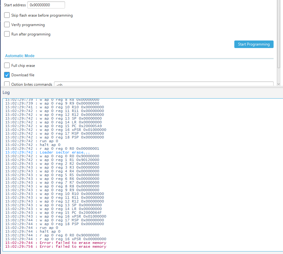

In case is useful for someone, i finally managed to complete the loader. I was having problems because i had no set the correct RAM size of my board in the linker file. Besides, i also had some troubles because my verification was failing only in some cases. in the end it was due to the fact that those binaries were bigger than my flash size, so it was being overwritted.

You have to deselect "discard unused sections", other way the compiler will erase the functions defined in Loader_src, as they are not being used. In my case i had not enough memory to deselect this option so what i did was calling these functions in the main loop. This way the compiler does not erase them because they are being "used". In order to see if that functions are being called from the stm32cubeprogrammer you can select the option "Verbosity level 3" in this program and see the memory address being called and compare them with the ones of the memory .map of your project. My first and only loader project is the one that i have attached previously. Good luck!!
