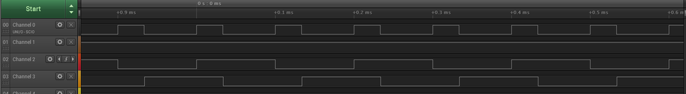

But what I get is the DMA transfer triggerd on the Update event...
Chanel0...PWM output
Chanel2... one of the GPIO bits controlled by the DMA
Chanel3... toggle pin on CC1IF set
Why is DMA transfer triggered on the Update and not on the Compare event? What am I doing wrong?

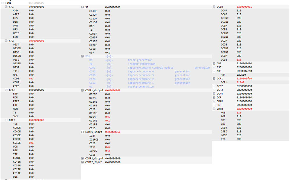

Sorry for the delay, I didn't have the board by my side for a few days...
Here is the content of the TIM1 registers right before enabling the timer
waclawek.jan
November 28, 2016
Posted on November 28, 2016 at 20:30
> CCDS  0x01
Don't.
Bit 3 CCDS: Capture/compare DMA selection
0: CCx DMA request sent when CCx event occurs
1: CCx DMA requests sent when update event occurs
waclawek.jan
November 28, 2016
Posted on November 28, 2016 at 20:33
I see the source of your confusion.
17.3.9  Output compare mode
When a match is found between the capture/compare register and the counter, the output
compare function:
Sends a DMA request if the corresponding enable bit is set (CCxDE bit in the
TIMx_DIER register, CCDS bit in the TIMx_CR2 register for the DMA request
selection).
Very badly formulated, but sadly it's no surprise.
