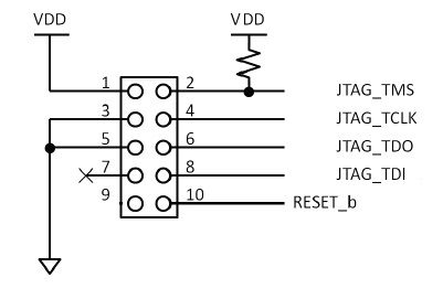

STM32F205xx using with J-Link Debug Interface
skylin
Posted on November 10, 2014 at 03:14
Hi All
Could anyone tell me whether I could using below 10-pin port as JTAG interface for STM32F205xx with J-Link debugger? Thanks!
1 REPLY 1
Posted on November 10, 2014 at 04:37
Yes, looks like a standard Cortex 10-pin 0.05'' JTAG/SWD Connector Pinout
