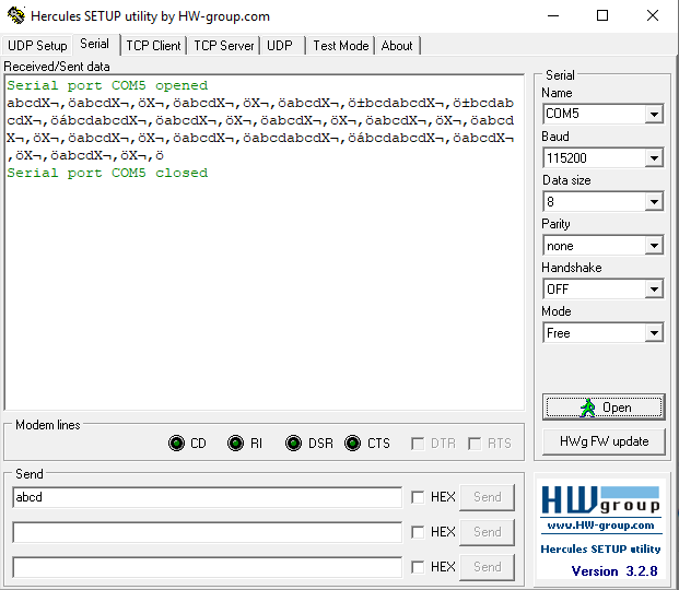

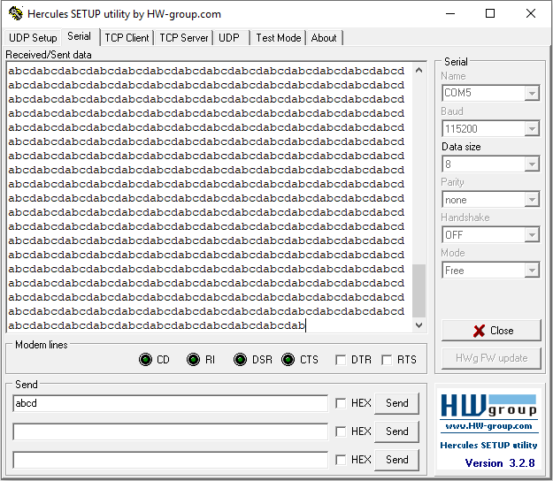

I have implemented an emulated UART on STM32F2 using the sample program from STM32F4. The UART TX data output is correct. Until a HAL_Delay(100) is add. When added delay, the UART TX output appears corrupted as shown below. Why is the HAL_Delay affecting the UART TX data? I have attached the whole project.0690X00000AqUYlQAN.png

Hi just to add on, I am sending abcd in ascii and the HAL_Delay(100) caused weird ascii text to appear too. The data seems to be corrupted due to the delay. But if I remove the delay, the data is received correctly.
Where are you calling HAL_Delay() from? Calling under interrupt/callback context will block, potentially any other interrupts at current preemption level and below (higher number)

I am calling it right after the while loop.
while (1)
HAL_Delay(100);
HAL_GPIO_TogglePin(LD2_GPIO_Port, LD2_Pin);
LED_State = HAL_GPIO_ReadPin(LD2_GPIO_Port, LD2_Pin);
HAL_UART_Emul_Transmit_DMA(&huart3Tx, tx_buffer_uart3, sizeof(tx_buffer_uart3));
while (__HAL_UART_EMUL_GET_FLAG(&huart3Tx, UART_EMUL_FLAG_TC) != SET)
