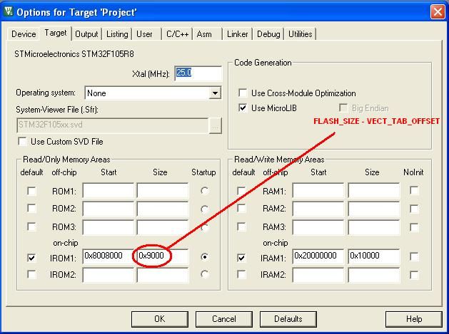

Posted on June 24, 2014 at 15:41
Probably because you haven't set up the target memory parameters correctly, or the linker script / scatter file.

Posted on June 25, 2014 at 08:37
The Application and Bootloader is separated.
The option target for Application in attached.

________________
Attachments :
Option_Application.JPG : https://st--c.eu10.content.force.com/sfc/dist/version/download/?oid=00Db0000000YtG6&ids=0680X000006I0fx&d=%2Fa%2F0X0000000beh%2F79pSp4wlNuLzYAqyevmpTo2AVFX.w1Shamk85PVWisE&asPdf=false
u23
Senior
Posted on June 25, 2014 at 11:46
I solved!
The solution consist in settings the parameters in application code:
1) In SystemInit function the ''VECT_TAB_OFFSET'' must be equal as 0x7000 (application address - 0x1000);
2) The Application needs to be compiled for the higher address (0x08008000) with size equal 0x9000 (flash size - VECT_TAB_OFFSET);
3) The first istruction in the main must be  NVIC_SetVectorTable(NVIC_VectTab_FLASH, 0x8000).

Posted on June 25, 2014 at 14:19
The VECT_TAB_OFFSET must be equal 0x7000 ( 0x8000 - offset) else not function! This for application.
You need configure the option device:
