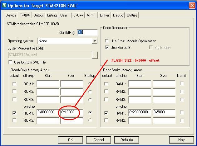

I have problem with jump to application by bootloader.
The device used is the STM32F105R8.
The bootloader does not jump in the application,it crashes in the function ''Jump_To_Application()''.
The code of the bootloader making the jump is:
#define APPLICATIONADDRESS    (uint32_t)0x08008000
/* Test if user code is programmed starting from address ''ApplicationAddress'' */
if (((*(__IO uint32_t*)APPLICATIONADDRESS) & 0x2FFE0000 ) == 0x20000000)
        /* Jump to user application */
        JumpAddress = *(__IO uint32_t*) (APPLICATIONADDRESS + 4);
        Jump_To_Application = (pFunction) JumpAddress;
        /* Initialize user application's Stack Pointer */
        __set_MSP(*(__IO uint32_t*) APPLICATIONADDRESS);
        Jump_To_Application();
In the application i have relocate the vector table:
int main(void)
    //    __disable_irq();
      /* Set the Vector Table base location at 0x8000 */
      NVIC_SetVectorTable(NVIC_VectTab_FLASH, 0x8000);
    //    __enable_irq();
    /***************** Add your application code here   ***************************/
I attached the image (bootloader + application) downloaded  from flash.

Awesome, I hope this all works out for you, but the presented facts appear internally inconsistent.

Look the ''stsw-stm32121_USB\STM32_USB-FS-Device_Lib_V4.0.0\Projects\Device_Firmware_Upgrade\binary_template'' use same method.
Bootloader ==> 0x08000000 to 0x08003000
Application ==> 0x08003000 to 0x08020000
In the main function set the Vector Table base location at 0x3000:
NVIC_SetVectorTable(NVIC_VectTab_FLASH, 0x3000);
The option target for application is:
Posted on June 26, 2014 at 14:03
Previously: The VECT_TAB_OFFSET must be equal 0x7000 ( 0x8000 - offset) else not function!
So 0x7000 when it's 0x8000 is consistent with this? 64K-0x8000 = 0x9000! And the binary generated with a ResetHandler at ~0x08007000 when the linker is set at 0x08008000

Posted on June 27, 2014 at 09:19
I agree with
you!
This is the only
method
that works!
I asked
clarifications
the
ST
support
but
do not respond
Posted on June 27, 2014 at 09:30
I've got quite a lot of mileage on these types of solutions (boot loader + app, STM32), if it misbehaves in the manner you describe the problem is most likely in the project (options/metadata), the files it actually uses (paths, defines, pre-processor), and the tool chain (linker).
Keil support might be a better avenue. For ST you'd probably want to go via your local distributor and their FAE's, and have them thoroughly replicate and understand your issue.
