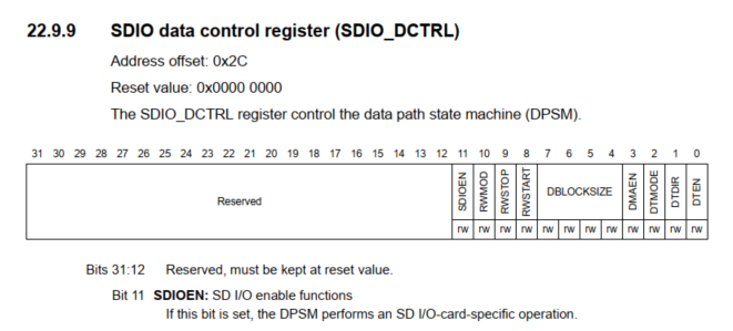

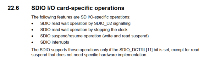

My current plan is as follows:
  1. Setup interrupt on SDIO cache being full (or half full); setup my micro-controller to detect that interrupt
  2. Program microcontroller to send read request to SDIO and than go back to what it was doing
  3. when SDIO gets the data, it will interrupt the microcontroller; it will store its state and do stuff with the data in the SDIO buffer. if i need more data from the SD, the interrupt handler will request more
  4. after handling the interrupt the microcontroller will back to doing what it was, until it gets interrupted/requires new data from the SD
Among other things, I do not exactly know how to implement the interrupt from the SD. for example:
  1. how do I make the SDIO send an interrupt. the ST reference manual RM0008 (found @ https://www.st.com/content/ccc/resource/technical/document/reference_manual/59/b9/ba/7f/11/af/43/d5/CD00171190.pdf/files/CD00171190.pdf/jcr:content/translations/en.CD00171190.pdf) mentions the following0690X000006DKHEQA4.png0690X000006DKLkQAO.png
  2.  But I am still uncertain as to how to set these registers to make the SDIO throw an interrupt when its recieve buffer is full (or half full)
  3.  I do not know how to configure the nested vector interrupt controller on the micro-controller to detect that interrupt
  4. I am not certain on how to connect that interrupt to a function in my code
  5. lastly, and perhaps most importantly, i need to figure how to restructure SdFat so that I can make it reads method command the SDIO to buffer data and than passes the processing thread back to the microcontroller (except for waiting for the data to come in)
