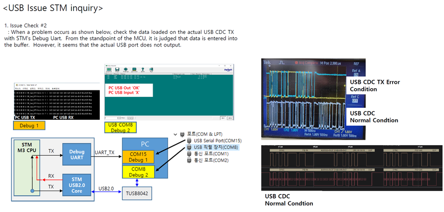

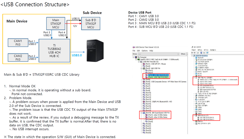

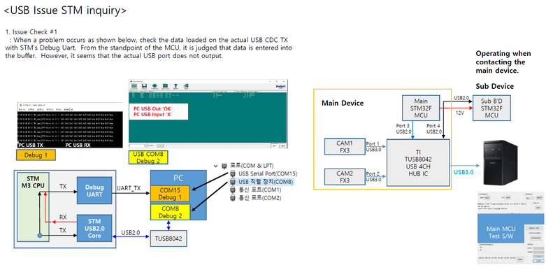

If the Sub device is connected as below, the USB CDC TX output of the Main device does not work.
Please refer to the information below.
I don't know the reason.

Thank you for responding. I am a system engineer. (H/W)
※ This problem occurs intermittently. But sometimes it happens frequently.
When "doesn't work", is "main mcu" still visible in the USB Treeview on PC?
> In the PC device manager, the Com port of the main MCU is maintained.
Does the PC poll this mcu through USB, are there PID IN packets on the bus towards this mcu?
>When the PC S/W is turned on and is normal, PID IN packets come at 50us intervals. (PC S/W is simply connected to the port)
When a problem occurs, it seems that only frame sync is output at 1 ms intervals. (I'll check it again.)
However, when a problem occurs, when PC S/W outputs TX data (USB CDC RX), the main MCU receives RX data and operates normally.
And after the operation, if the response is sent through USB CDC TX, it was confirmed that it enters the buffer.
However, no data is actually sent to the PC.
