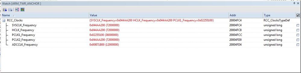

The system clock is conveyed via HSE_VALUE define, the PLL settings will also need to change. Some debuggers can provide a peripheral view showing configuration settings.
One could also send a stream of 'U' characters and confirm baud timing with an oscilloscope.
Internal clocking could also be check by programming PA8 in MCO mode.

Posted on June 08, 2016 at 14:57
This is what I see in debug mode. Watching this values and the prescale that I've set seems that the in an 8Mhz oscillator...right?

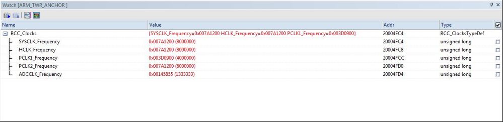

Posted on June 08, 2016 at 15:21
I've modified the code in this manner and for me the oscillator is an 8Mhz. Other ideas?
