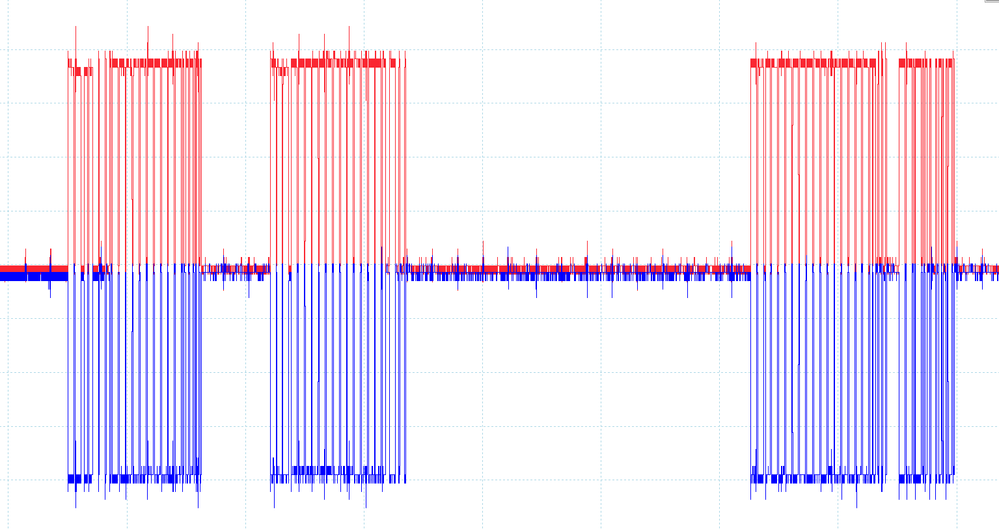

The CANL and CANH signals from the transceiver are connected to the CAN bus on which there are already two nodes and they communicate with each other with baudrate = 500kBps (4 frames run on the network):
0693W000005BbAyQAK.pngSo network is working.

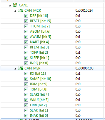

ststus = CAN_Init(CAN1, &CAN_InitStructure);
I got value equal to 1, so CAN protocol is correctly implemented and it is in normal mode. This situation is confirmed by values of registers:

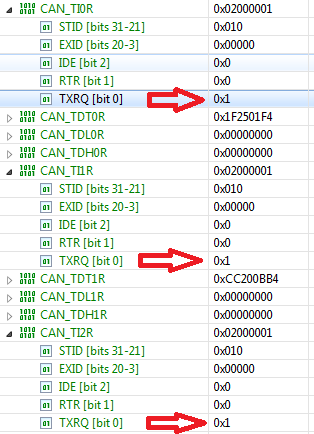

The result is that transmission status is set to pending (the value is returned by the CAN_TransmitStatus function) for all FIFO banks, what is confirmed by registers:

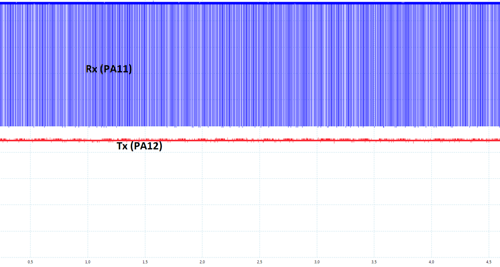

After connection oscilloscope between microcontroller and transceiver I can notice that transceiver allow for transferring CRX frames (PA11 pin), o that I conclude that transceiver works properly:
Summing up, maybe someone has an idea why STM does not send a frame to the transceiver but is in pending mode all the time?
