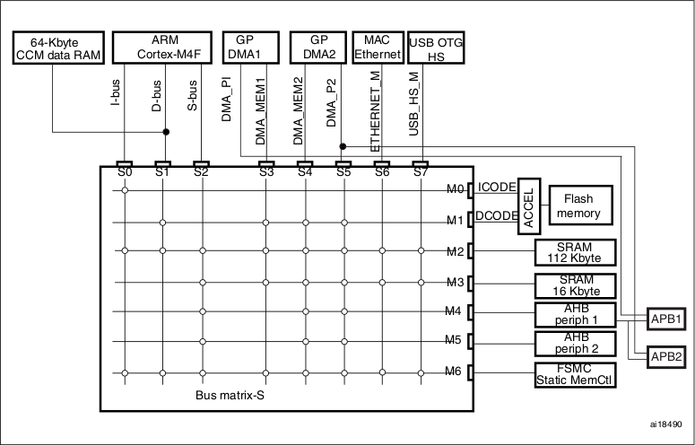

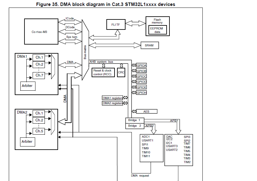

LRold.1
but this is not a bus matrix diagram. I need this:
without this diagram how can i know if AHB can communicate with DMA CH1, DMA CH2 or both?
i appreciate the help
waclawek.jan
The 'F1 DMA is different from the 'F2/'F4/'F7 DMA. It's single-port, i.e. it has only one channel towards the bus matrix; and there's no direct APB connection from it. See AN2548.
