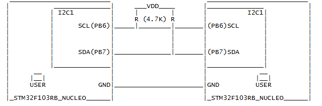

  1. try to start withI2C examples under the STM32F1 firmware package: STM32Cube_FW_F1_V1.4.0\Projects\STM32F103RB-Nucleo\Examples\I2C
  2. Connect the 4.7k pull-up resistor as it is shown in the figure below

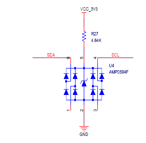

Took some time to get the schema.
So I have this funny drawing on the slave STM32F101T6U6ATR side.
I'm not a HW guy, so I roughly understand there's a 4.7 pull-up resistor, but will be glad to understand the details... thanks :)
I ran the STM32Cube_FW_F1_V1.4.0\Projects\STM32F103RB-Nucleo\Examples\I2C\I2C_TwoBoards_ComIT slave application on the board, connected to the STM32F072B-DISCO master, which sends 10 bytes ''0123456789'', but the slave constantly got stuck after the 8'th byte.
Posted on February 09, 2017 at 11:06
that is a very unusual circuit.
and looks incorrect.
Did you make this circuit ?
or is it on a board that you purchased ?
the part AMP0504 is basically an ESD protection device. protecting the 3v3 rail and the SDA and SCL lines for OFF board connections.
but pin 5 should be connected directly to the rail3v3
and then SCL and SDA should have their own separate pullups.  4k7 or 10k is ok for 100KHz
in the circuit above the SDA line is not pulled up. and therefore is unlikely to run correctly.
the AMP part is not needed if all the signals reside on one board.

Posted on February 09, 2017 at 11:43
You definitely  need the extra pull-up, that other part is useless in its current form, but it wont stop it working after you add the SDA pullup.
