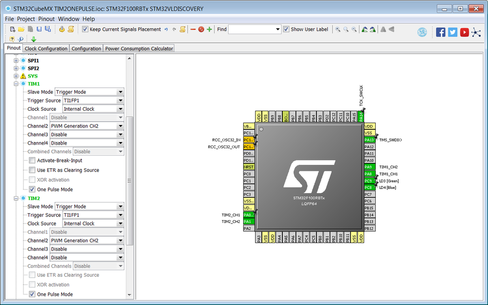

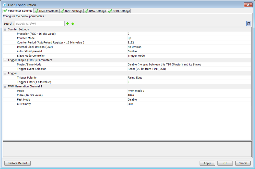

Thanks everyone. Most things are easy, once you know the answer
Below is the STM32CubeMX config (for 2 timers, I got bold), and the info for Timer 2. The timers should be started with this code:
HAL_TIM_OnePulse_Start(&htim1, TIM_CHANNEL_1); HAL_TIM_OnePulse_Start(&htim2, TIM_CHANNEL_2);I would now like to start Timer 2 from Timer 1 being started instead of the button (I have wired the button to Timer 1 as well). Working to try to figure out that next.

In TIM1 once set to trigger from the input (button), set TIM1_CR2.MMS to 0b001, so that enable signal is used as TRGO.
In TIM2, set TIM2_SMCR.TS to that Internal Trigger which is coming from TIM1, see TIM2 row of table at TIMx_SMCR description in RM. Then set TIM2_SMCR.SMS to 0b110 for Trigger mode.
That's all.
