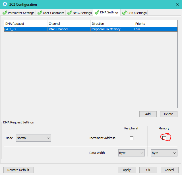

I am new to STM I started with the STM32100E-Eval Board which features an STM32F100Z3 MPU and a STLM75 temperature sensor, which connects to the MCU via I²C2. Using STM32CubeMX, I set up the hardware end enable I2C2 and corresponding I2C2 event interrupt. Now, I try to read the temperature value in no-blocking mode. Unfortuately, I haven't found any application notes or example applications using the HAL no-blocking mode yet. I've tried the following code:

My first question is: What is the correct value for MemAdressSize? Bits or Bytes?
I guess, this code should trigger an interrupt, but the following printf never gets executed:

I almost got it to work. Now I can read the temperature register [HIGH], but the [LOW] value always reads 0x80 (meaning 0.5 ). The same effect occurs when I try to read the TOS or THYS registers of LM My code is:

Well I have actually gotten to read the temp register but I can't read the other registers config, thyst and tos.
Your call to HAL_I2C_Mem_Read_IT is almost correct
correct one is
HAL_I2C_Mem_Read_IT(&hi2c2, 0x90, 0x00, 0x01, (uint8_t*)SensorData, 2)

Hello !
Also your I2C2 DMA settings transfers only a BYTE. to memory (the last)
Check the increment address box to transfer to ''
SensorData'' all bytes requested.
