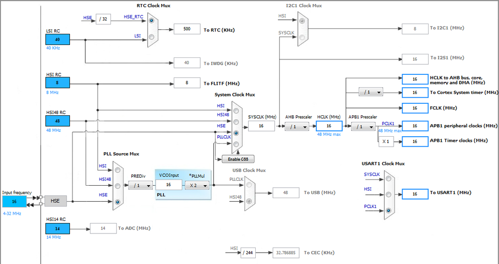

Hi, I'm here again! Now I put an external 16MHz oscillator. I measured the frequency of the crystal with the oscilloscope and seems to be all right. But now I have an error of 12 minutes to every 24 hours. My application is totally dependent on the correct RTC and should work for 45 uninterrupted days.So I wonder if this error is normal for an external crystal or there may be something wrong with my settings.

‎2016-03-30 2:43 AM
hrtc.Init.AsynchPrediv = 125;
hrtc.Init.SynchPrediv = 4000;
Are you sure?
Consult the RTC prescaler register chapter in RM, and Cube's manual's RTC section.
‎2016-03-30 6:08 AM

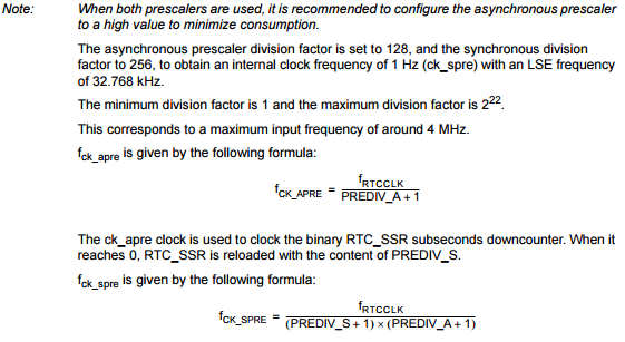

Thank you JW, it's my fault. The dividers starts from 0. Probably this is the problem isn't?Now I will test with this setting: hrtc.Init.AsynchPrediv = 124;
