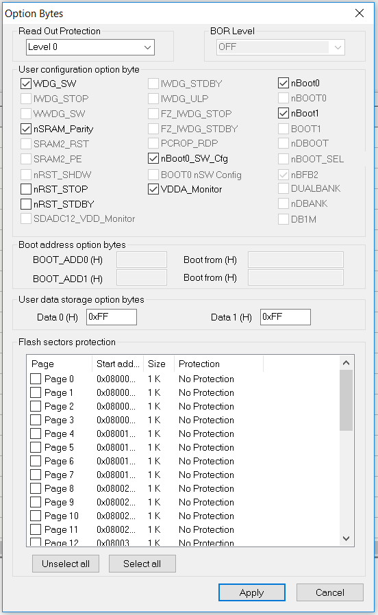

I just made a discovery. By forcing reset line low during SWD ''negotiating'' I am able to connect to and program the target via STLINK Utility. I can also do this when going into debug mode in SW4STM32, but the connection fails when I press Run.
Also forgot to mention that the other target I managed to program normally did not have the reset line connected at all. STLINK utility probably fell back on programming without reset?
So here I managed to read out my option bytes. I am investigating it now to the best of my knowledge, but you may chime in if you see anything:

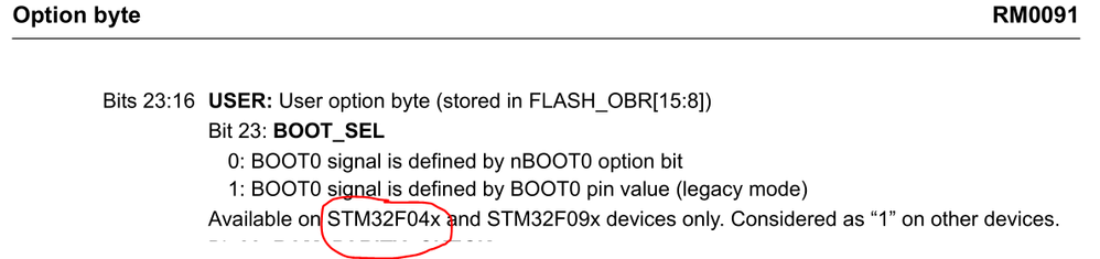

This should maybe go into a new thread, but why is nBOOT_SEL greyed out in the image above? Reference manual says this option is for choosing whether pin or software puts you in bootloader mode:

I expected to run the bootloader from within 'system memory'. In previous STM32s I've worked with where I was not the software architect I simply pulled the BOOT0 pin high when powering the device, and it entered bootloader mode and did not execute code from main flash memory. This is not what I'm seeing here.
Okay. I'm thinking low power mode, interfering with GPIO pins, etc., but I don't understand where I am going with it? In what context did you say that? Can I interfere with the BOOT0 pins by configuring it as GPIO? I think not, but since you're mentioning it. Do you need to see my schematic?
