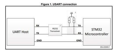

 Is it possible to program an empty STM32F042 using UART1 instead of SWCLK-SWDIO?
I want to flash programming of STM32F042 which is zero.

If you hold BOOT0 high during reset, it will boot into the bootloader. You can then use UART to program it.
STM32CubeProgrammer can do this for you if you have a USB to UART adapter and hook it up to the correct pins. See AN2606 for supported pinout.

If I do BOOT0 high (always pulled up) and connect USB to UART adapter TX-RX to STM32f042C4U6 as picture, May I program all flash with STM32CubeProgrammer?
BOOT0 will need to be Low for normal operation once programmed.
Ok, so when programming from UART BOOT0 must be high, after programming we have to do low BOOT0 for normal operation, right?
Yes
