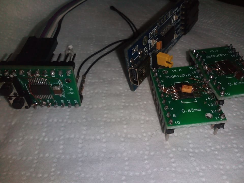

Dear forum members,
I hope you can help solving a mystery. I stumbled upon these cute stm32f030f4 µCs and built minimalistic boards with it. No external oscillator used, thus pins PF0 and PF1 should be useable as GPIOs. I tried several things already. Current state is explicitly disabling HSE, deinit the clock system and setting it up correctly:

It doesn't make a difference whether the HSE-Disable is before or after deinit. I also modified CMSIS/stm32f0xx.c -> SysCLKinit so HSE was disabled by all means, but that didn't help either. Further pin setup:

Setup for the pins as Alternative Function, AF0 or AF1, didn't make a difference. I'm running out of ideas what else to do to get all 15 GPIOs working. Maybe someone already managed that and has a pointer to the solution. Thanks for taking the time to read through all this! :) 0690X00000602xiQAA.jpg #pf1 #gpio #stm32f030 #pf0

Problem solved: I need to go back to the soldering station.
Just replaced the board with another one I built and it immediatly works, even without calling the ''RCC_HSECmd''; RCC_DeInit() suffices.
Great, now I can use 15 IOs! :)
