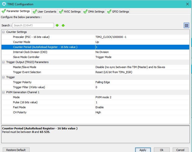

Hi,Here is what you need for this:
  • you need to clock the timer to get a resolution of  1degree using the system clock and prescale register
  • you use the zero crossing to trigger the timer start (this will happened 2 times per cycle)
  • load the compare register with the count required for a phase delay ( 180- phase delay) this is where you want the trigger to happened this value will remain in the register until you change it .
  • Load the ARR register with the max count value should be less than 180 (half a cycle) . you have to account for the frequency stability  ( Ã‚± 1Hz max= 179, Ã‚±2Hz max = 178 ...) other wise you could get flickering
set the following option in the Timer register (they vary with the Timer and channel used so refer to the reference manual):
  1. set output active when  COUNTER = COMPARE REGISTER
  2. set the pulse polarity to your requirement
  3. transfer the holding register to the working register at the end of the cycle ( you can write new value anytime )
  4. One pulse mode
  5. start the timer from the trigger input
have fun

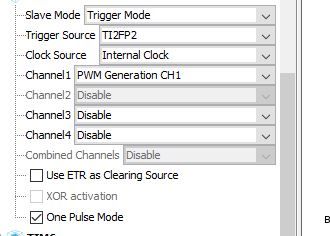

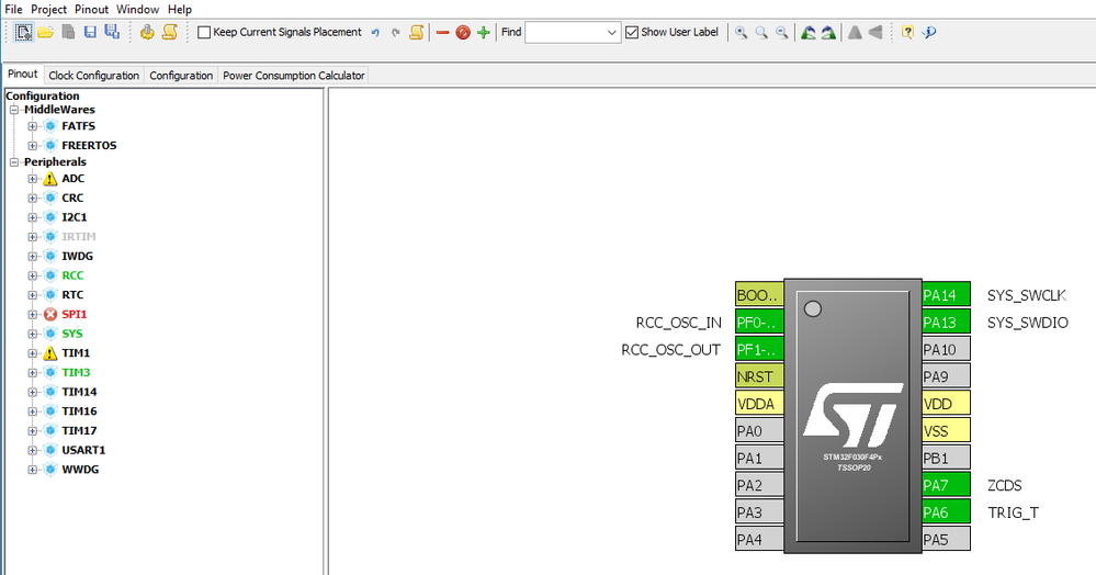

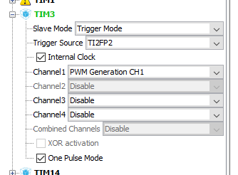

Posted on August 17, 2017 at 08:04
Hello Vangelis,
Sorry for the delay. I got pulled away from this due to unavoidable circumstances.
Anyway I tried out the code you so kindly typed out. It didn't work. Instead something strange happened. The ZCD input went high even though i configured everything exactly as you've mentioned. The TRIAC never fires no matter what the value of
SetPhasePercent(value); is set to
. A print screen of my configuration in STM32CubeMX is attached here in. The code's a copy-paste of yours as above. All other settings remain unchanged.
Thank you for your help.
