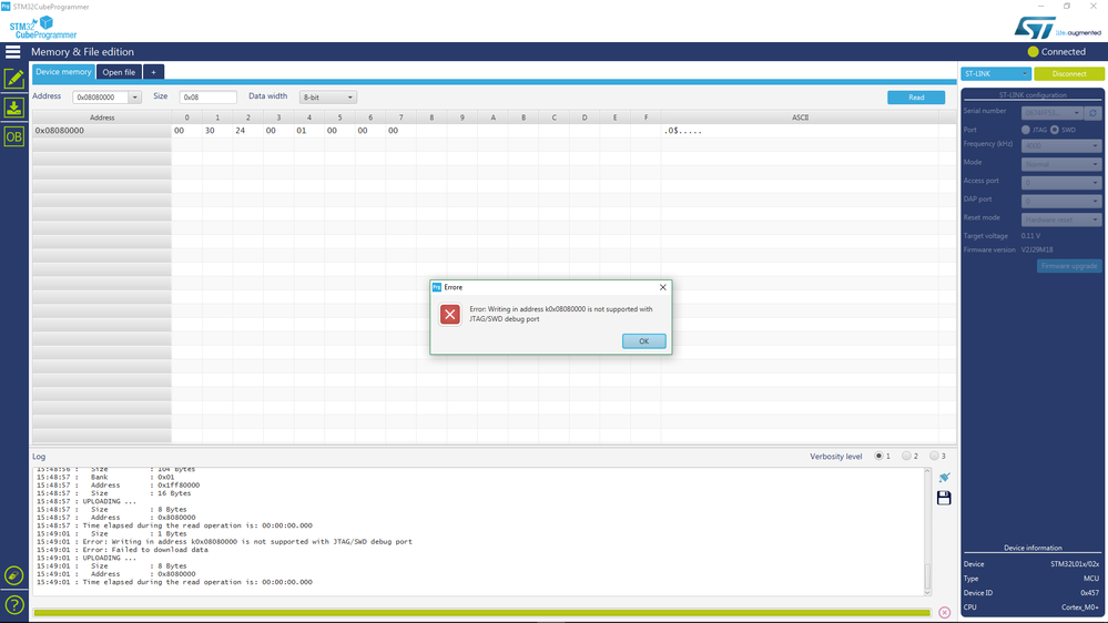

Hi, I have a micro STM32F011F4 and I try to write in EEPROM via
SWD but cube programmer shows an error message (also from CLI) how can I write in EEPROM? (STM32 STlink utility works well) Thank youMarco
1 REPLY 1
Options
2018-01-11 3:27 AM
Posted on January 11, 2018 at 12:27
Hi Marco,
Programming STM32L0/L1 internal EEPROM is not yet supported by STM32CubeProgrammer, only Internal flash is managed. This feature will be added in coming releases.
