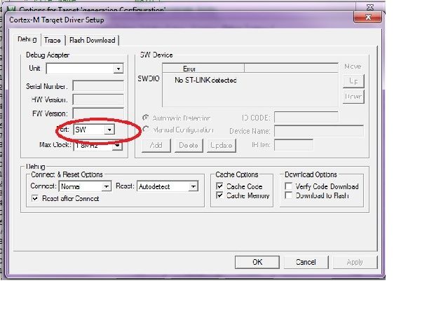

I am trying to generate initialization code for STM32F427ZITx.
Clock and peripherals configuration in a CubeMX is OK.
Code generation is OK.
All main files (startup, system, HAL drivers, initialization routines) in a generated project seem to be in place,
But, when I open a generated project in MDK-ARM, nothing seems to be configured in a Run-Time Environment. And, as far as I understand, the Cube should take care of it.
The configuration project builds fine in MDK. But when I am trying to run a debug session, it starts at 0x1FFF5162, and, of coarse, doesn't run.
Loading application to the flash doesn't work either.
Am I missing something?

Hi gennady,
For debugging, verify that the connection is serial. go to Options for target..->Debug->use ST-link debugger->settings->Port:SW. Also, verify the choice of the flash under flash download.
Hope, this can help.
Regards
Posted on July 04, 2015 at 18:12
My fault.
The BOOT0 pin on a board was hardwired to 1, so controller booted in a system memory.
And I didn't pay attention.
