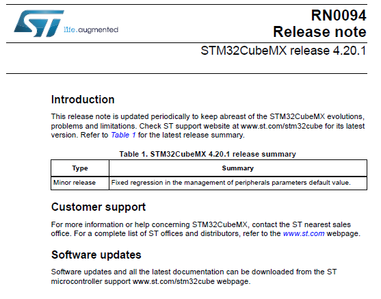

STM32Cubemx stuck in ''Generating user source code''
n.serina
Posted on April 08, 2017 at 08:29
I recently installed cubemx 4.20 latest version 4.20.1
I can generate the project only 1 time, later if i try to update the project by adding new peripherals, i can not able to generate the code, the whole application is stuck in 'Generating user source code '. the only way i can close this application is killing it by 'Task manager'. it happens every time. Please help

Jeanne Joly
Senior III
Posted on April 12, 2017 at 15:15
Hello
n.serina
In fact, the problem you highlighted is solved in CubeMX4.1.
Please, upgrade with the latest release of CubeMX.
Here is a screen shot of the CubeMX4.1 release note :
Hope it will help you and that you won't encounter this issue in the future.
BR. Eric
Posted on April 13, 2017 at 05:04
Hi
Joly.Jeanne
It would be helpful to us CubeMX users to have more more completeinformation in the release summary. Nothing in the referencedsummary indicates to me a fix to a hang within the CubeMX code generator. A separate 'Release Notes' section that went into more detail about the specific fixes that were made would also be helpful. And so would a public issue tracker (with references to resolvedissues in the release notes).
We'd also like to see apublic git repo for CubeMX and the HAL libraries. Many of us wouldlove to help ST make the Cube software and HAL libraries a better product.
Rob
Posted on April 13, 2017 at 09:53
Hello
Riggs.Rob
On the CubeMX release summary, we have a particular section for each official release with all the trackers listed (Id and headline) that are delivered in. (please, have a look to the
http://www.st.com/content/ccc/resource/technical/document/release_note/b2/02/4b/e3/81/32/49/c4/DM001076pdf/files/DM001076pdf/jcr:content/translations/en.DM001076pdf
For the CubeMX release 4.1, it is more specific as we should not have this intermediate/minor release but we discovered an important issue in CubeMX 4.0. Only one bug was delivered in CubeMX4.1 (compare to CubeMX4.0).
That is why you only have one sentence that describes the issue we encountered in CubeMX4.

n.serina
Posted on April 13, 2017 at 18:00
Thank you so much for the help, i came to know that after updating my KEIL-MDK-5 software, the issue got resolved automatically,

dpryan2
Posted on April 14, 2017 at 02:17
It is also broken for me.
I'm using 4.20.1.
The log doesn't say anything exciting. Here are the last few lines:
[INFO] CodeGenerator:404 - code generatio: config db path: C:\Program Files (x86)\STMicroelectronics\STM32Cube\STM32CubeMX//db/
[WARN] IP:1042 - AutoBaudRateEnableParam not found: check if there is a RefParameter without a condition.
[INFO] CodeEngine:162 - oldGeneratedFile, C:\Projects\someproject\Src\license.tmp_save
[INFO] CodeEngine:180 - Generated code: C:\Projects\someproject\Src\license.tmp
Edit: Maybe I wasn't waiting long enough? 9 minutes later, it completed.
