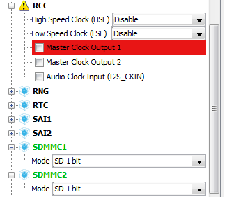

I have
/external-link.jspa?url=http%3A%2F%2Fwww.st.com%2Fen%2Fevaluation-tools%2Fnucleo-f722ze.html
And Trying to access Two microSDCards Simultaneously . One by One (Either SDMMC1 or SDMMC2 is working fine)
https://community.st.com/0D50X00009XkWKfSAN

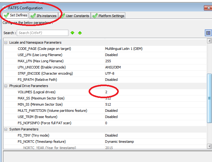

Below is my STM32Cube Configuration Setting
Rest all default .

With above code I can only access one microSD Card Only.
I am not able to access both micro SDCards simultaneously . By Added Drive number .
Please help me to resolve this ..
