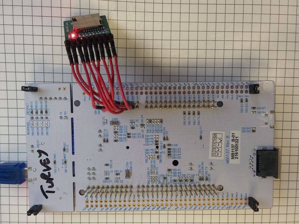

Posted on February 15, 2018 at 21:59
Banged my head on this working on the H743ZI-NUCLEO this morning, had been working via the VCP/USART3 and then started porting the SDMMC project. The symptom looked like an issue with HSE_VALUE so the first thing I checked. Likely other errors, pulled these two with a quick scan, but does highlight the need for more rigour in the releases here.
Didn't manage to get the SDMMC to work on the board, and did strip out the level converter stuff. Have pivoted back to the F767ZI-NUCLEO to get that working with the MicroSD socket to sanity check things.
The STM32H743I-EVAL arrived so will bang on that too.

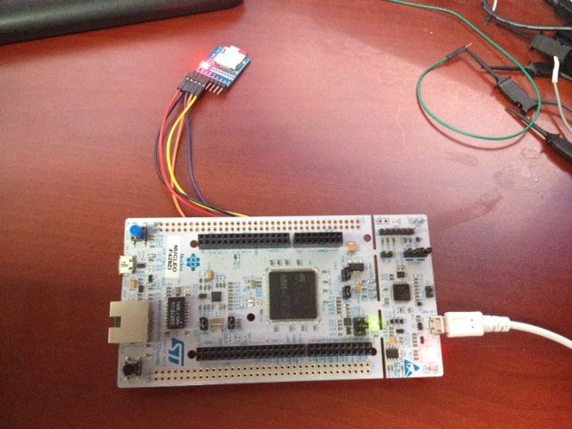

Posted on February 15, 2018 at 23:30
I'd picked up several of the ViewTool version
https://www.ebay.com/itm/1pcs-NEW-Micro-SD-Card-Module-Slot-Socket-Reader/272798769771
Nucleo F767ZI
Core=216000000, 216 MHz
CPUID 411FC270 DEVID 451
Cortex M7 r1p0
STM32F76xxx or F77xxx
C0000000 FFFFFFF8 00000000
10110221 12000011 00000040
FPU-D Single-precision and Double-precision
APB1=54000000
APB2=108000000
FatFs Testing (68300)
SystemCoreClock: 216000000
Mounting FatFs
FAT32
   30.4 GB total drive space
   30.3 GB available
  100.3 MB used
----        113 /DIR.TXT
----        175 /LOG.TXT
D---          0 /RINEX
----   32768000 /SPEEDTST.BIN
D---          0 /BASE_301
----       2494 /RINEX.INI
32768000 Bytes, 524170395 Cycles
 13.50 MBps Read  (FatFs)
32768000 Bytes, 524151419 Cycles
4864 ms
 13.47 MBps
200005A0 512
CrcFile Size:32768000 BufferSize:512
  32768000 CRC32:65744B39 PKZIP:9A8BB4C6 SPEEDTST.BIN
200005A0 1024
CrcFile Size:32768000 BufferSize:1024
200005A0 4096
CrcFile Size:32768000 BufferSize:4096
200005A0 20480
CrcFile Size:32768000 BufferSize:20480
200005A0 32768
CrcFile Size:32768000 BufferSize:32768
200005A0 40960
CrcFile Size:32768000 BufferSize:40960
200005A0 65536
CrcFile Size:32768000 BufferSize:65536
Done..
Infinite loop...
