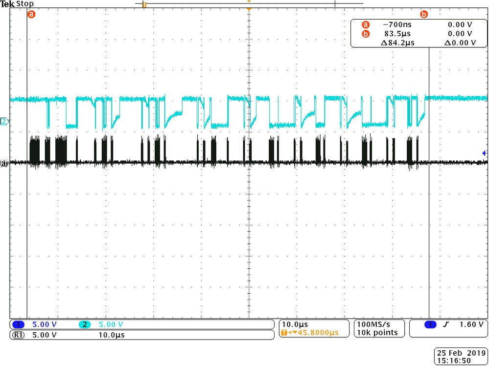

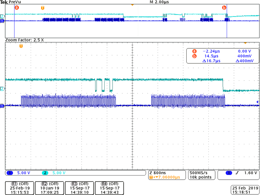

Here some code extract to give you directions:
I used this link to get baseline: https://www.cnblogs.com/shangdawei/p/4753040.html
You will short MISO and MOSI outside. Here is STM32L4R5 in BGA132 @ 48MHz SYSCLK (low power) with 12 MHz SPI

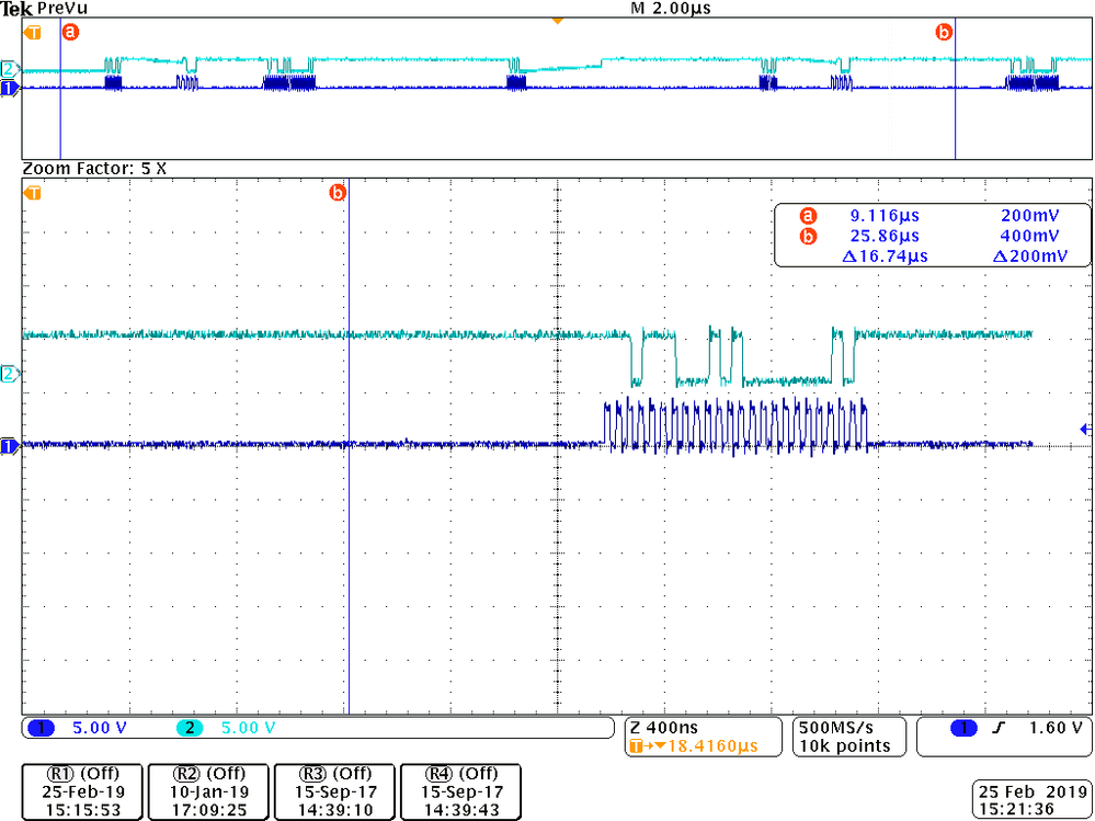

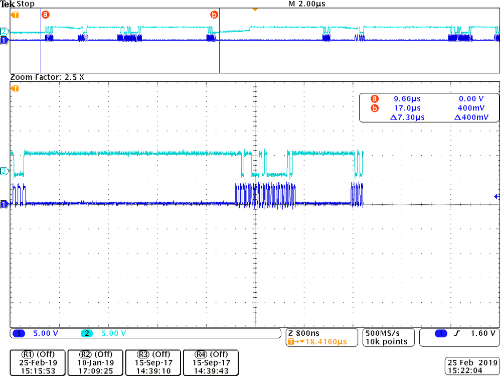

Part 2 (this forum can't put all in one answer...)
Then you get something like this:

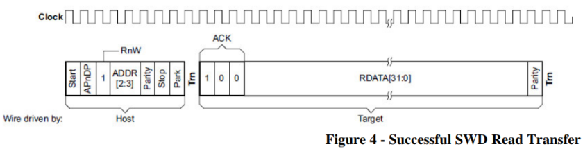

void SWD_Read(uint8_t cmd, uint32_t* pdata32) {
  uint32_t readback;
  uint8_t Regs[7];
  SWD_WaitIdle();
  FlushRxFifo();
  *(__IO uint8_t *)&SPI3->DR = cmd; // CMD transmit 8 bit
  SWD_WaitIdle();
  SWD_RxMode();
  SWD_SetSPICR1Slower();
  SWD_SetBits(5);
   *(__IO uint8_t *)&SPI3->DR = 0x99; // move 5 bits
  SWD_WaitIdle();
  readback = *((__IO uint16_t *)&SPI3->DR); // read past 8 + 5 bit
  SWD_SetSPICR1Normal();
  SWD_SetBits(8);
  Regs[0] = readback & 0xFF;
  readback >>= 8;
  Regs[1] = readback;
  SWD.Ack = (readback & 0x0E)>>1;
  SWD.du32 = (readback & 0x10)>>4;
  SWD.bitsum = SWD.du32;
  if(SWD.Ack!=0x01) { // NOK
    // error and abort
    SWD_TxMode();
    return;
  // OK, so now we read the leftover bits (lsb is captured already)
  *(__IO uint8_t *)&SPI3->DR = 0x99; // move 8 bit LSB
  *(__IO uint8_t *)&SPI3->DR = 0x99; // move 8 not
  SWD_WaitIdle();
  Regs[2] = *((__IO uint8_t *)&SPI3->DR);
  Regs[3] = *((__IO uint8_t *)&SPI3->DR);
  Regs[4] = *((__IO uint8_t *)&SPI3->DR);
  SWD_SetBits(9);
  *(__IO uint16_t *)&SPI3->DR = 0x9999; // move 8+1 bits
  SWD.temp32 = Regs[2];
  SWD.du32 |= (SWD.temp32<<1);
  SWD.bitsum ^= NibbleBitCounter[(SWD.temp32>>0) & 0x0F];
  SWD.bitsum ^= NibbleBitCounter[(SWD.temp32>>4) & 0x0F];
  SWD.temp32 = Regs[3];
  SWD.du32 |= (SWD.temp32<<9);
  SWD.temp32 = Regs[4];
  SWD.du32 |= (SWD.temp32<<17);
  SWD_WaitIdle();
  Regs[5] = *((__IO uint8_t *)&SPI3->DR);
  Regs[6] = *((__IO uint8_t *)&SPI3->DR); // turnaround bit included
  SWD_SetBits(8);
  SWD_TxMode();
  // we rebuild all decoded values
  SWD.temp32 = Regs[5];
  SWD.du32 |= ((SWD.temp32&0x7F)<<25);
  SWD.bitsum ^= NibbleBitCounter[(SWD.temp32>>4) & 0x0F];   // includes parity bit
  SWD.parity = (SWD.temp32 & 0x80)>>7;// optional
  // calculate the parity bit
  //if((SWD.bitsum)/*||(SWD.du32!=0x2BA01477)*/)
  //  NOPs(1);
  *pdata32 = SWD.du32;

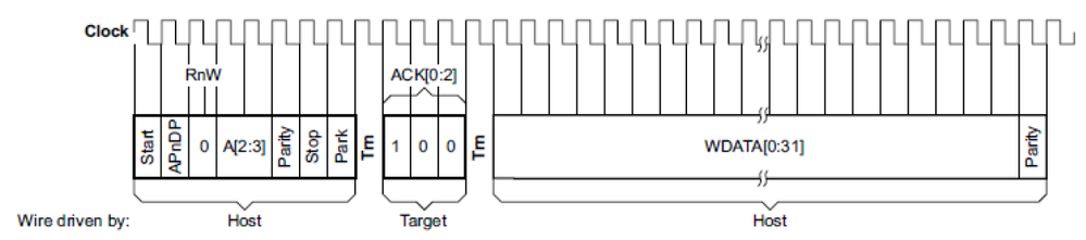

SWD_CmdStatusT SWD_WriteDAPRegSPI(uint8_t cmd, uint32_t data) {
  SWD.Retrials = 0;
  do { // send the command until ACK or WAIT with timeout
    SWD_Write(cmd, data);
  }  while(     (  (SWD.Ack == 0x02) )
                &&   ((SWD.Retrials++)<30)
  if(SWD.Retrials>SWD.WriteCmdWaitMax)
    SWD.WriteCmdWaitMax = SWD.Retrials; // keep track of the max nb of retrials for a write
  switch(SWD.Ack) { // analyse the command's answer
  case 0x01: // OK
    SWD.CmdStatus = SWD_CMD_OK;
    break;
  case 0x02: // TIMEOUT
    SWD.CmdStatus = SWD_CMD_WAIT;
    break;
  case 0x04: // FAULT
    SWD.CmdStatus = SWD_CMD_FAULT;
    break;
  default: // other error
    SWD.CmdStatus = SWD_CMD_ERROR;
  return SWD.CmdStatus;
void SWD_Write(uint8_t cmd, uint32_t data32) {
  uint32_t readback;
  SWD_WaitIdle();
  FlushRxFifo();
  *(__IO uint8_t *)&SPI3->DR = cmd; // Transmit CMD 8 bit
  SWD_WaitIdle();
  SWD_RxMode();
  SWD_SetBits(5);
  *(__IO uint8_t *)&SPI3->DR = 0x99; // send 5 bits = Tn ACK Tn
  SWD_WaitIdle();
  readback = *((__IO uint16_t *)&SPI3->DR); // read the answer
  SWD_SetBits(8);
  SWD_TxMode();
//  SWD.Regs[0] = readback & 0xFF;
//  SWD.Regs[1] = readback >> 8;
  SWD.Ack = (readback >>9) & 0x07;
    NOPs(1);
    // error and abort
    return;
  *(__IO uint8_t *)&SPI3->DR = (data32 >>0) & 0xFF; // send 8 bit (hopefully)
  *(__IO uint8_t *)&SPI3->DR = (data32 >>8) & 0xFF; // send 8 bit (hopefully)
  *(__IO uint8_t *)&SPI3->DR = (data32 >>16) & 0xFF; // send 8 bit (hopefully)
  // Here we prepare the data to transmit Regs[2..3..4..5]
  // LSB to MSB
  SWD.temp32 = data32;//SWD.Regs[2] | (SWD.Regs[3]<<8) | (SWD.Regs[4]<<16) | (SWD.Regs[5]<<24);
  SWD.bitsum  = NibbleBitCounter[(data32>>0) & 0x0F];
  SWD.bitsum ^= NibbleBitCounter[(data32>>4) & 0x0F];
  SWD.bitsum ^= NibbleBitCounter[(data32>>8) & 0x0F];
  SWD.bitsum ^= NibbleBitCounter[(data32>>12) & 0x0F];
  SWD.bitsum ^= NibbleBitCounter[(data32>>16) & 0x0F];
  SWD.bitsum ^= NibbleBitCounter[(data32>>20) & 0x0F];
  SWD.bitsum ^= NibbleBitCounter[(data32>>24) & 0x0F];
  SWD.bitsum ^= NibbleBitCounter[(data32>>28) & 0x0F];
  SWD.parity = SWD.bitsum;
  SWD.temp32 = ((data32 >>24) & 0xFF ) |((SWD.bitsum & 0x01)<<8); // parity bit
  SWD_WaitIdle();
  SWD_SetBits(9);
  *(__IO uint16_t *)&SPI3->DR = SWD.temp32; // send 9 bit (hopefully)
  SWD_WaitIdle();
  FlushRxFifo();
  SWD_SetBits(8);
This is a fun experiment, you can start/stop/reset the core, read/write internal RAM.

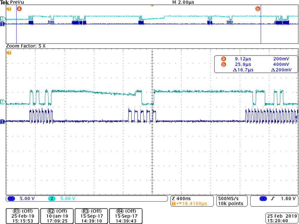

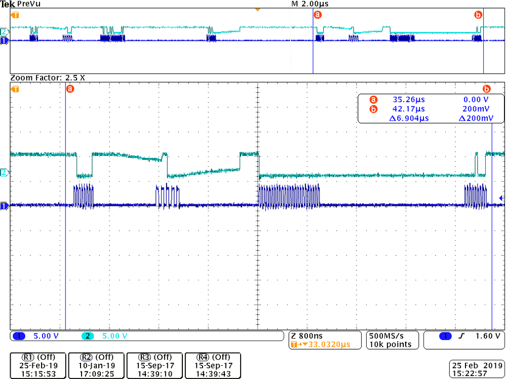

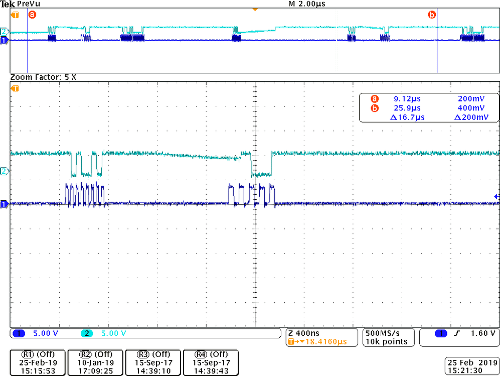

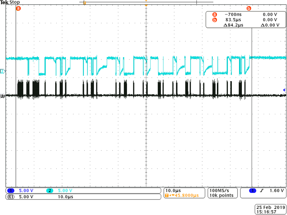

SPI speed tuning, rugged test, higher level error management has not been done.
Consider this as pseudo code to shrink dev time only.
Some pictures
So to have a even fast communication, the SPI should have a special mode where the data register is split in MSB = bit length with R/W, LSB = data bits
Then the delay between packets could be minimized and average speed improved further. A true 3 wire interface would save 1 GPIO unless voltage shifting required outside.
