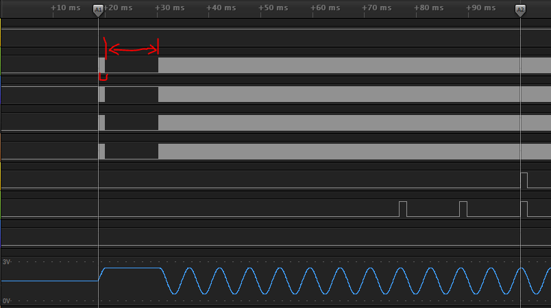

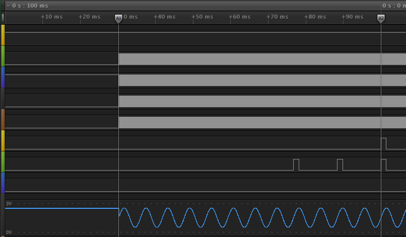

. That's fine as I can simply zero this register before restarting, to ensure the output is in sync. The problem is that the timer is stopped at some arbitrary point in time at which the repetition counter is at some arbitrary value, and when the output is restarted, the repetition counter appears to resume from this arbitrary value, thus introducing a short delay or phase shift in the output, proportional to the remaining count. So the first run of the output after powerup is always correct and in sync:0690X0000060Bg2QAE.png
This shows all the outputs going from off to on, as expected.

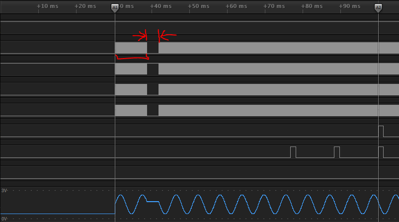

However, second and subsequent times we stop and start the PWM output, we see the output starts but then stops unexpectedly leaving a variable length gap right after, then resumes and continues correctly:
Each time the device stops and restarts, the gap is of a variable length. I am manually resetting the
TIMx_CNT
register before enabling the PWM output. The varying size of the gap, which appears to have a maximum size, is completely consistent with the repetition count not starting from 0.
