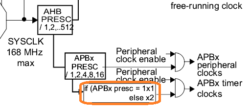

That would suggest you are using an APB2 timer clocking at 168 MHz. APB2 might be at DIV2 (84 MHz), but TIMCLK will be at DIV1 (168 MHz). See Clock Tree

@Clive - Well, it took me a little while for what you wrote to click. Yes I now understand and so far all testing is working.
168000000 / 840 = 200000
200000 = 20 * 10000
this.Period = (10000 - 1);
this.Prescalar = (20 - 1); this.Duration = (10000 / 2);Output Frequency: 840Hz
// *******************************************************************168000000 / 160 = 1050000
1050000 = 105 * 10000
this.Prescalar = (105 - 1); this.Duration = (10000 / 2); Output Frequency: 160Hz// *******************************************************************
168000000 / 23456 = 7162.3465211459754433833560709413
7162.3465211459754433833560709413 = 2 * 3581
this.Period = (3581- 1);
this.Prescalar = (2 - 1); this.Duration = (3581/ 2); Output Frequency: 23.46KHz// *******************************************************************
So, simple you were right, my in-experience did over look this Clock issue by the looks of it. Some confusion entered the picture: 168000000 / 2 = 84000000 - I real all over the web that APB2 was 84000000 and it is but the calculation you gave is not for the divider product, its for the Clock for APB2. 84000000 is only CK_CNT, not the APB2 Bus Speed: clock frequency = 168000000.Factoring:

The TIMCLK is typically twice the APB clock, it's often useful for timers to clock as fast as possible.
On the F4 running at 168 MHz, APB1 is typically 42 MHz (DIV4) and APB2 84 MHz (DIV2), and the respective TIMCLKs are 84 MHz, and 168 MHz. The APB2 timers are ALL 16-bit, presumably due to the cost of clocking a 32-bit counter at 168 MHzUp vote any posts that you find helpful, it shows what's working..

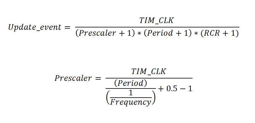

@All - Some equations that I hope will help others. It has taken me a fair while to get this topic right. I hope this helps others.
UPDATE: JW has kindly provided Document numbers that show some equations: The update event period is calculated as follows: Update_event = TIM_CLK/((PSC + 1)*(ARR + 1)*(RCR + 1)) Where: TIM_CLK = timer clock input PSC = 16-bit prescaler register ARR = 16/32-bit Autoreload register RCR = 16-bit repetition counter (where present) Thanks JW. URL:http://www.st.com/web/en/resource/technical/document/application_note/DM00042534.pdf

Instead of spawning various equations with arbitrarily chosen variable names, why don't you resort to the STM32 documentation, namely the timer chapters in user manuals and application notes, e.g. AN4013?
The update event period is calculated as follows: Update_event = TIM_CLK/((PSC + 1)*(ARR + 1)*(RCR + 1)) Where: TIM_CLK = timer clock input PSC = 16-bit prescaler register ARR = 16/32-bit Autoreload register RCR = 16-bit repetition counter (where present) JW
