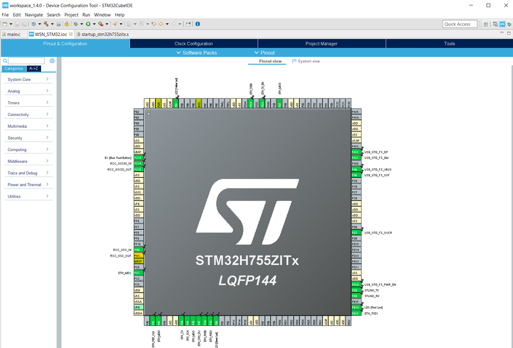

0693W00000QODqWQAX.pngPreviously I wrote a program for - Nucleo-H755ZIQ in which I used SPI- UART- RTOS.
After a long time, I wanna make a new stm32 project and reuse some previous function I was using correctly before.
The problem is that not only those functions don't work but also I can not even set and reset an led .
Here are my function which were working on the current MCU:

Hi , the probnlem was that I forgot to assign SPI_CS pin to the m7 Core inside the CubeMX .

Hi @STork.1​
I would like to know what changed since it was working (Hardware or software changes)?
Then, can you test with a ready to use example from STM32CubeH7? This example should work properly for NUCLEO-H755ZI
Best regards,
FBL
STork.1
