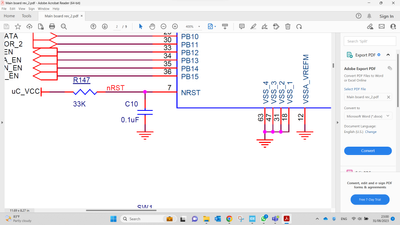

We are using STM32L452 for our project.
We have problem with pin NRST.
We set a 30K pull-up resistor (with pull-down capacitor of 0.1uF).
Sometime voltage on the NRST pin is 3.3V and sometimes it is 1.4V.
In cases it is 1.4V the MCU is stuck.
We think that in case of 1.4V happens because a pin leakage current.
Do you have any solution for us ?

In addition to the tips from @TDK, please note that the PIN NRST can also be an output (see the Reference Manual RM0394), able to drive the pin from inside.
Please also note that in contrast to MCUs of the last millennium, a pull-up is no longer necessary (is also stated in the RM mentioned before). Examples like on the Blue Pills or Black Pills should be seen as a bad example here.
Provide a schematic of what you've actually built, be easier than guessing.

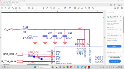

Got all the analogue supplies wired?

Could be a power issue. The portion of your schematic that you showed wouldn't be causing this issue. Measure VDD when NRST is at 1.4V.

I will measure VDD for NRST=1.4V.

  1. Have you checked that your Vdd supply is a stable 3.3 Volts? Maybe that's changing.
  2. Can you put an oscilloscope on the reset pin and the Vdd? (Ch1 Vdd, Ch2 Reset, then turn on watch out for smoke)
  3. Are you sure your resistor is 33 k and not 330 k? (I did)
  4. Have you checked the capacitor is OK?
  5. The Reset pin hasn't got a solder bridge to another pin (mine did)
  6. You aren't changing the NRST pin function in your GPIO initialisation?
